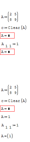

I can't reproduce the issue (see the screenshot), could you attach an example (worksheet and screenshot)?

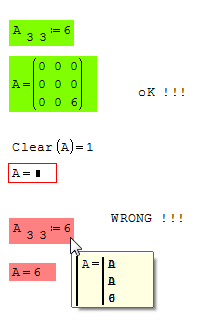

Confirmed and explained in the attachment.
Clear() deletes the value of a variable but the type is set to line(). Element assignment to line()-variables outside the existing range generates unpredictable results.
If you want to do matrix element assignment with a cleared variable then you have to change the type first by assigning a (possibly empty) matrix.
