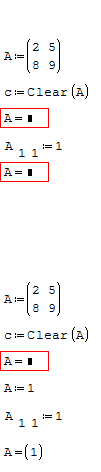

I have a question about Clear Fontion.
For scalar Number there's no problem with Clear Function.
But with Matrices and Vector Clear Function do not work.
Indeed, after used Clear Function with matrices ,
I can't redefined the matrice variable wich is cleared like a matrice.
I have to redefined the variable like a scalar end then like a matrice.

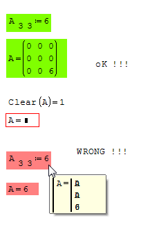

I can't reproduce the issue (see the screenshot), could you attach an example (worksheet and screenshot)?

#7 Posted: 6/22/2013 2:46:10 AM
Confirmed and explained in the attachment.
Clear() deletes the value of a variable but the type is set to line(). Element assignment to line()-variables outside the existing range generates unpredictable results.
If you want to do matrix element assignment with a cleared variable then you have to change the type first by assigning a (possibly empty) matrix.
Clear.sm (40.93 KiB) downloaded 1419 time(s).
