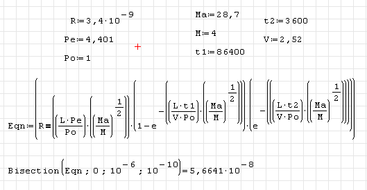

I am new to SMath. So far it's great I am impressed. I've been searching the forums for a solution to my situation. I haven't found anything yet.
Can someone educate me on this?
Any help would be greatly appreciated.
Here's a screenshot:
I know R from our mass spec measurements. I need to go back and find L (the actual leak rate of the device). There is no way to solve for L directly.
The answer for R=3.4*10^-9, L=5.612*10^-8... this is from a lot of work on my TI-85... I'm not 100% sure it's right...

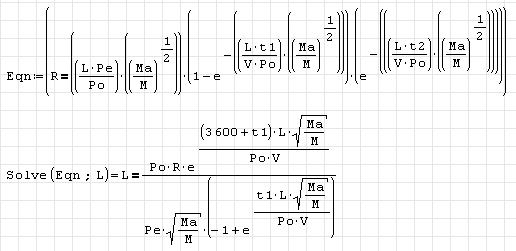

Thanks, I'm not sure this solves my problem. This looks like it rearranged the equation, but did not solve for L.

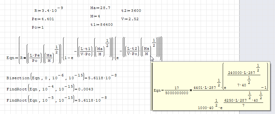

This awesome. I know for certain that the solution for L when R= 3.4x10^-9, is 5.614x10^-8.

Sweet, adding the nonlinearSolvers plugin got me past the Bisection() and FindRoot() part. At this point I think I have my answer, but the plot is cool and I am going to have to figure that part out. For some reason I'm getting the "failed to load" problem still...
