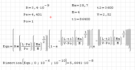

I am new to SMath. So far it's great I am impressed. I've been searching the forums for a solution to my situation. I haven't found anything yet.
Can someone educate me on this?
Any help would be greatly appreciated.
Here's a screenshot:
I know R from our mass spec measurements. I need to go back and find L (the actual leak rate of the device). There is no way to solve for L directly.
The answer for R=3.4*10^-9, L=5.612*10^-8... this is from a lot of work on my TI-85... I'm not 100% sure it's right...

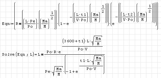

You might try the Maxima-Plugin

Thanks, I'm not sure this solves my problem. This looks like it rearranged the equation, but did not solve for L.

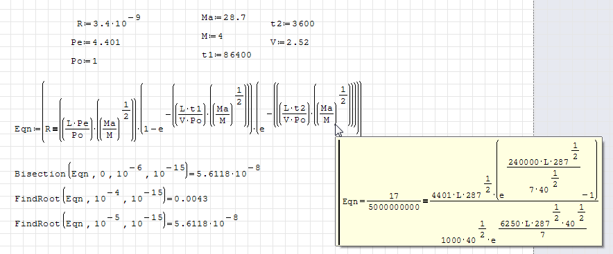

You are right, I did not really inspect the result, sorry for that. Here is another proposal.
#6 Posted: 1/18/2014 4:22:15 AM
Martin suggests that you try to find L symbolically. Maxima returns L=f(L) which means that the function is nonlinear. Then you will go for a numerical solution. Numerical equations could be tricky. The best is first to try to plot it - to see the possible guess values and to see if there might be more solutions. See the pictures with the Maxima's L=f(L) rearanged equation and with your original (try to avoid so many braces - it is not needed). The second picture is with your original equation. This one is much more problematic for numerical solving. It seems that you need quite good guess value to get the second solution or you are going to get some value around zero, which is another solution (see the pictures). If you try to rearrange the eqaution is some other way, you might get no solution at all.
I do not know if this solution even have sense to you. There is another problem.
Leak Rate Calculation-1.sm (30.64 KiB) downloaded 1302 time(s).
#7 Posted: 1/18/2014 7:46:10 AM
1,361 likes in 2,275 posts.
The equation has two solutions. Plotting the function f(L) is not very easy in the built-in plot region. Here is an example for how this can be done using the Maxima-Plugin. Not user-friendly either, but full control provided.
Leak_draw.sm (16.45 KiB) downloaded 1381 time(s).

This awesome. I know for certain that the solution for L when R= 3.4x10^-9, is 5.614x10^-8.
So it appears there are many ways to get there. This is the first time I've used the program and I'm excited about all the possibilities. I'm going to try them all just to learn some more.
Thanks again!
I get "failed to load" error... any ideas?
Martin's example works perfectly for me. A nice one to see the possibility of Maxima and draw package in SMath. Thank you Martin
I suppose that here is the problem with Maxima plugin. Not loaded correctly or not installed at all.
