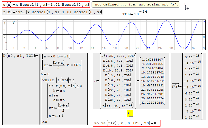

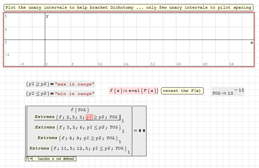

Hello Jean Giraud,
Thanks again for your attention to my questions.
Could you help me with one more question?
Why can't I calculate in the file "Nikolai roots.sm"?
Clicking the "Recalculate page" button gives the error "F() - function isn't defined.".
Is this a problem in different versions of the program or a problem in another?
WroteWhy can't I calculate in the file "Nikolai roots.sm"?
Total and impressive disaster !
Possibly, your Smath installation is defective ?
Possibly, your Smath version is kaput ?
On that last point, Designers can confirm.
I will make a PDF, so you will be able to code/sanity.
Cheers ... Jean.
... run that test version. At worst, code as given.
You can'y escape eval(x*Bessel(1,x)-1.01*Bessel(0,x))
Cheers ... Jean.
