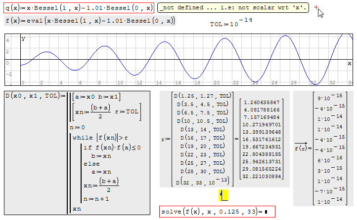

... few more things in this project:
1. roots & Golden ratio in plot.
2. integration/derivative.
Cheers ... Jean.
Nikolai roots.sm (116,28 КиБ) скачан 1280 раз(а).

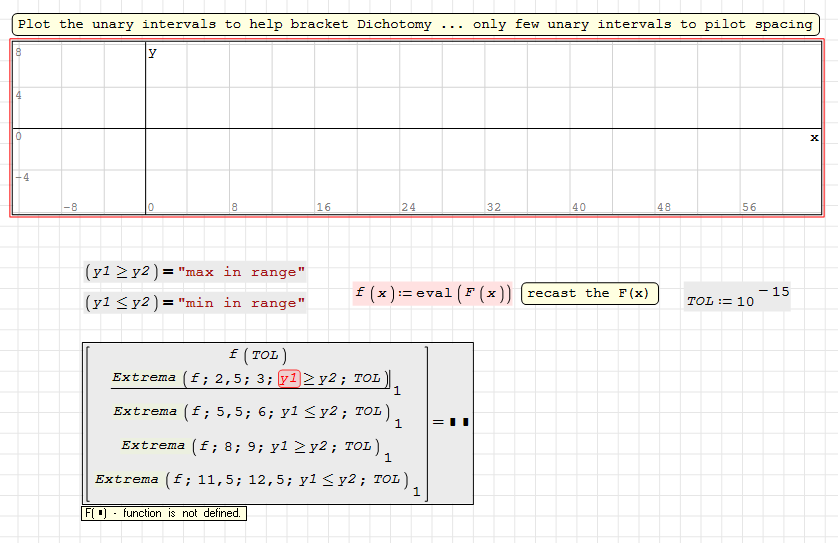

Hello Jean Giraud,
Thanks again for your attention to my questions.
Could you help me with one more question?
Why can't I calculate in the file "Nikolai roots.sm"?
Clicking the "Recalculate page" button gives the error "F() - function isn't defined.".
Is this a problem in different versions of the program or a problem in another?
#23 Опубликовано: 05.09.2022 10:31:51
Total and impressive disaster !
Possibly, your Smath installation is defective ?
Possibly, your Smath version is kaput ?
On that last point, Designers can confirm.
I will make a PDF, so you will be able to code/sanity.
Cheers ... Jean.
#24 Опубликовано: 06.09.2022 08:06:23
... run that test version. At worst, code as given.
You can'y escape eval(x*Bessel(1,x)-1.01*Bessel(0,x))
Cheers ... Jean.
Nikolai roots Test.sm (14,75 КиБ) скачан 1293 раз(а).
