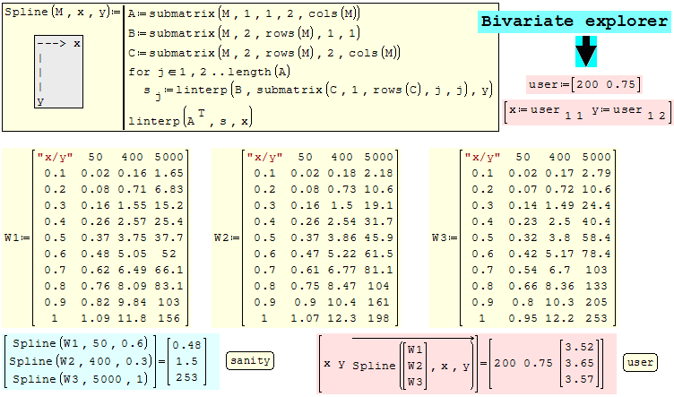

SMath Forum SMath Studio Samples Spline/Interpolate Matrix 1 Pages (3 items) Spline/Interpolate Matrix - Spline/Interpolate Matrix - Messages Go to last post #1 Posted: 2017/11/22 22:45:06 Jean Giraud 983 likes in 6,866 posts. Group: User Spline Matrix Tutorial METRIC Domain.sm (88.16 KiB) downloaded 1229 time(s). 2 users liked this postfrapuano 2017/11/23 03:48:00, sergio 2017/11/23 08:36:00 #2 Posted: 2017/11/23 08:39:27 Jean Giraud 983 likes in 6,866 posts. Group: User The bivariate "linterp" is reputed behaves like QuadraticSpline Matrix Tutorial METRIC Domain EXPLORER.sm (14.73 KiB) downloaded 1163 time(s). #3 Posted: 2017/11/23 19:19:57 Nicolae Olaru 1 likes in 115 posts. Group: User Hello.I think I understand the idea. I will think about this. Thank you for your insistence. However, it also counted the very simple and schematic form you used here and you did not use it on the other subject. With respect and all the best. 1 Pages (3 items) New Posts No New Posts
