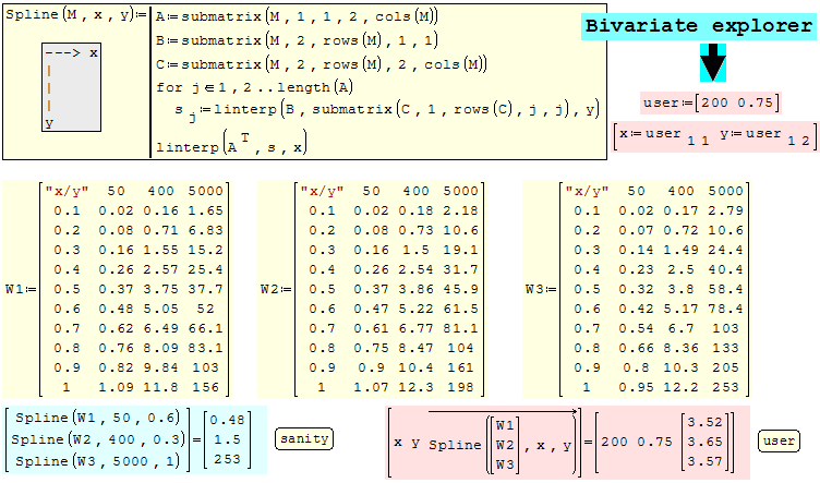

The bivariate "linterp" is reputed behaves like Quadratic
Spline Matrix Tutorial METRIC Domain EXPLORER.sm (14.73 KiB) downloaded 1342 time(s).

Hello.
I think I understand the idea. I will think about this. Thank you for your insistence. However, it also counted the very simple and schematic form you used here and you did not use it on the other subject. With respect and all the best.
