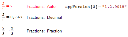

If the fractions setting is set to Auto, the result formatting looses the denominator.
Users might be surprised by this. If not, even worse.

Thank you, Martin!
I will handle this.
