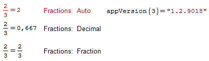

SMath Forum SMath Studio Bugs & Problems Setting "Fractions: Auto" is dangerous 1 Pages (2 items) Setting "Fractions: Auto" is dangerous - Messages Go to last post #1 Posted: 9/14/2024 4:53:10 PM Martin Kraska 1,361 likes in 2,275 posts. Group: Moderator If the fractions setting is set to Auto, the result formatting looses the denominator.Users might be surprised by this. If not, even worse.Worksheet3.sm (4.18 KiB) downloaded 1683 time(s). Technische Mechanik mit SMath Studio: https://link.springer.com/book/10.1007/978-3-658-50592-9 6 users liked this postsergio 9/14/2024 5:02:00 PM, ioan92 9/14/2024 6:27:00 PM, oscar mauricio 9/14/2024 8:44:00 PM, Alvaro 9/15/2024 3:53:00 AM, Davide Carpi 9/18/2024 5:38:00 PM, Andrey Ivashov 9/20/2024 4:41:00 AM #2 Posted: 9/20/2024 4:41:51 AM Andrey Ivashov 2,343 likes in 4,055 posts. Group: Super Administrator Thank you, Martin!I will handle this.Best regards, Andrey Ivashov. 1 users liked this postsergio 9/21/2024 5:54:00 PM 1 Pages (2 items) New Posts No New Posts
