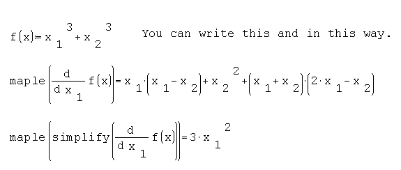

It's the way SMath handles/prioritizes ASCII characters. I ran into a similar issue with MathCAD. In this case, the second variable of "x" (in the equation) has to be the first variable of the first derivative as shown in w3b5urf3r's screen shot.

#8 Posted: 2013/5/3 16:32:12
Yes, I know. Thank you . I did it on purpose, just to put the stress that maple did it right.
