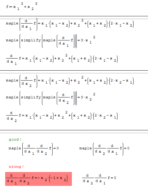

#3 Posted: 7/30/2012 6:59:59 PM
Hi omorr,
I confirm!
seem related to the symbolic simplification (see the attachments)
regards,
w3b5urf3r

WroteHello,
This is still present in 0.95 build 4594 (30 July 2012).
Any comments?
I confirm!
regards,
w3b5urf3r
derivatives_debug.sm (36.92 KiB) downloaded 1359 time(s).

It's the way SMath handles/prioritizes ASCII characters. I ran into a similar issue with MathCAD. In this case, the second variable of "x" (in the equation) has to be the first variable of the first derivative as shown in w3b5urf3r's screen shot.
