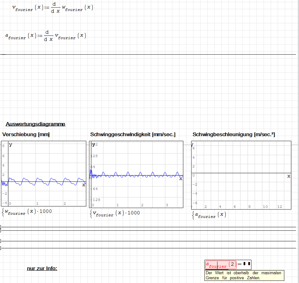

In some case there ist no Result in v(fourier) and a(fourier) diagram but this message:
need some Help please.
Thanks Thomas

The function is needed for inspection.
#3 Posted: 2021/1/25 12:12:23
That shape or very similar was fitted in Mathcad 11,
fitted linfitCheby order 99, not possible Smath ... order 99 too big.
It may be why you can't plot derivative, i.e: your Fourier too high order.
#4 Posted: 2021/1/25 15:15:56
Wrong reply ... explain:
The Smath derivative operator is essentially the same from your Calculus book.
Fourier is the sum of trig sin/cos Σ that at some point derivative operator
does not recognize w/o complaining.
What you can do from your clean looking plot, discretize the function,
next => plot the FD derivative [FD = Finite differences].
Attach the function, I will finish for the derivative.

Check and cross check your formulas and how you defined the equations (e.g. "[" for a matrix). At the moment, if I define x:0,0.1...1, the result for V.fourier(x) says that the "result is above the max allowed positive number"
In addition, W.fourier cannot be calculated, but the graph is visible

I guess not. Your worksheet seems to have all ok, and because of that I try to just take the derivative for a "simple" univariate function evaluating symbolically w.fourier, and copy and paste the result. The error in the derivative remains. So, the issue it's related with the numeric procedure in the SMath derivative, but not with your work and you haven't too much to optimize in your code. As workaround you can use your own numeric derivative.

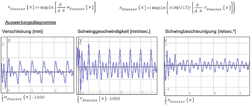

Well, if that's true, you only need to simplify two univariate functions, the speed v and the acceleration a. For v maple() it's enough, for a needs an explicit simplify command.

My problem is solved and I learned a lot . Thanks!!!
