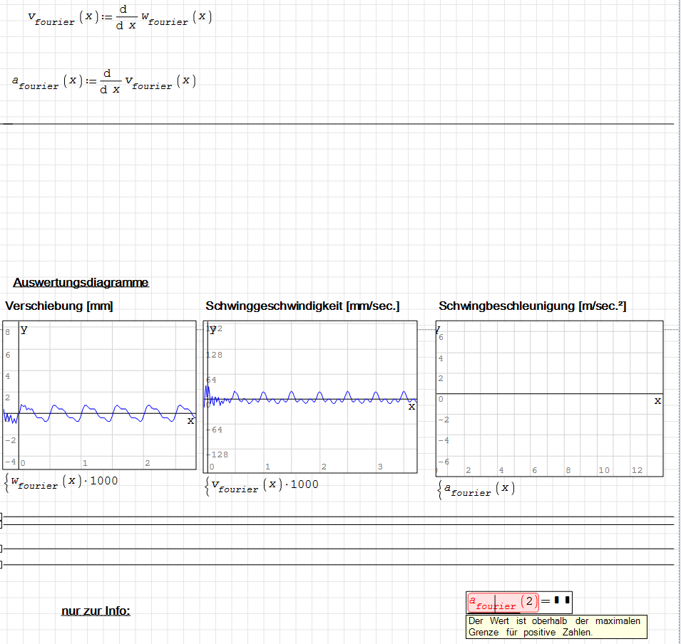

In some case there ist no Result in v(fourier) and a(fourier) diagram but this message:
need some Help please.

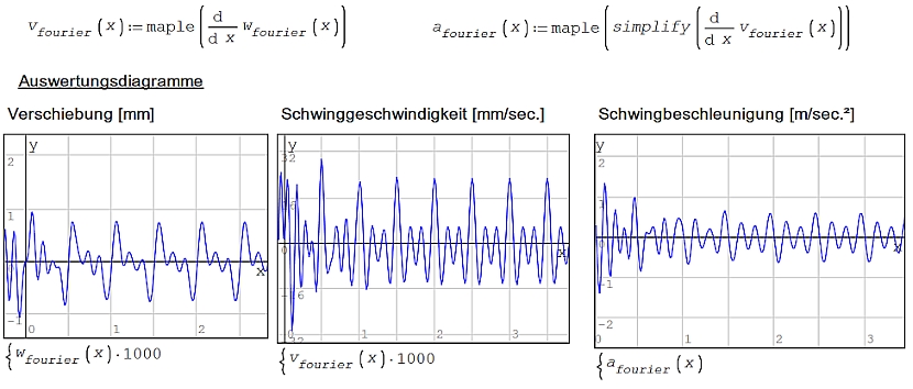

Hallo everyone...
the script works in Version build:7030 and doesnt works in the latest build 7610. see the different screenshots here.
The Smath-script is attached.... Maybe there ist a lot for optimising...
I´m very thankfull for further tips..
Greatings Thomas sorry for this bad english.... it isn´t as good as I want.... File not found.File not found.File not found.

Check and cross check your formulas and how you defined the equations (e.g. "[" for a matrix). At the moment, if I define x:0,0.1...1, the result for V.fourier(x) says that the "result is above the max allowed positive number"
In addition, W.fourier cannot be calculated, but the graph is visible
I guess not. Your worksheet seems to have all ok, and because of that I try to just take the derivative for a "simple" univariate function evaluating symbolically w.fourier, and copy and paste the result. The error in the derivative remains. So, the issue it's related with the numeric procedure in the SMath derivative, but not with your work and you haven't too much to optimize in your code. As workaround you can use your own numeric derivative.
w.fourier.sm (30.76 KiB) downloaded 1545 time(s).
I don't know if this is useful in your work, but this procedure is well know for mathcad for extend a function over a period:
periodic.sm (9.84 KiB) downloaded 1574 time(s).
The use of mod or floor is only for numerics, but for symbolics you can use the heaviside function, which actually SMath haven't.

Well, if that's true, you only need to simplify two univariate functions, the speed v and the acceleration a. For v maple() it's enough, for a needs an explicit simplify command.
LF_Aufschaukeln_4_Pers_Personenanregung_Fluchttreppe_allg__optional_getilgt.sm (408.3 KiB) downloaded 1671 time(s).
