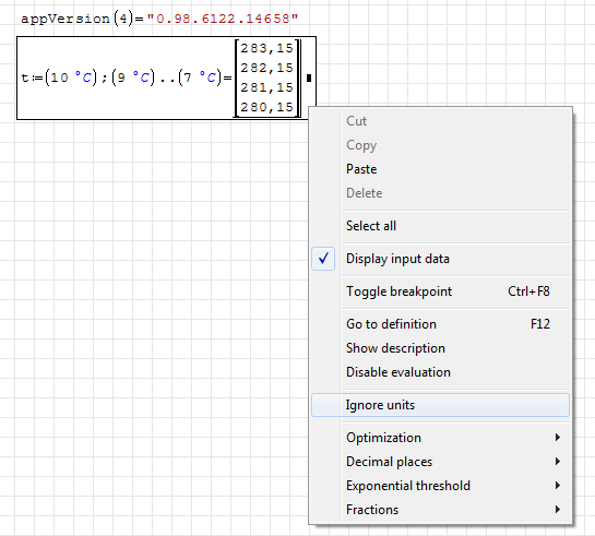

Units are lost in range(2):
С уважением, Михаил Каганский

#5 Posted: 2016/10/6 06:42:00
Confirmed
#6 Posted: 2016/10/6 10:18:03
Mike Kaganski
Mike Kaganski
184 likes in 434 posts.
Problems with "[", "]", "\" and units in range are fixed in appVersion(4)="0.98.6123.7493"
