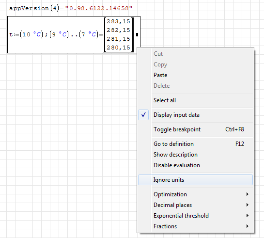

Units are lost in range(2):
С уважением, Михаил Каганский
Radovan Omorjan 06.10.2016 06:42:00
Confirmed

Problems with "[", "]", "\" and units in range are fixed in appVersion(4)="0.98.6123.7493"
