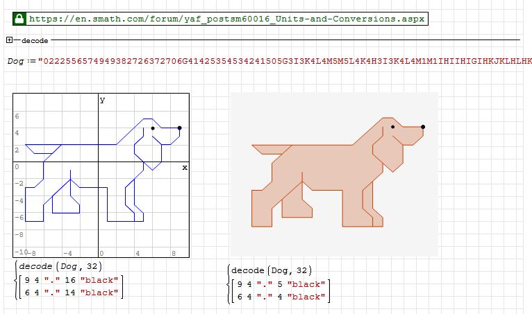

d2d-paper-dog.pdf (45.95 KiB) downloaded 983 time(s).
d2d-paper-dog.sm (12.7 KiB) downloaded 1669 time(s).

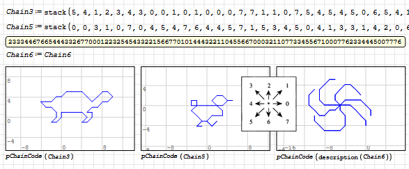

Chain Code.sm (17.74 KiB) downloaded 1654 time(s).
