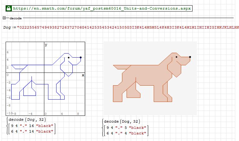

#10 Posted: 12/14/2024 12:51:22 AM
1,555 likes in 1,867 posts.
d2d-paper-dog.pdf (45.95 KiB) downloaded 1094 time(s).
d2d-paper-dog.sm (12.7 KiB) downloaded 1834 time(s).
