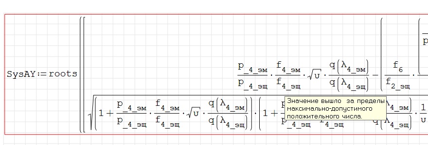

Who has faced such a problem, how can it be solved?
Project from below

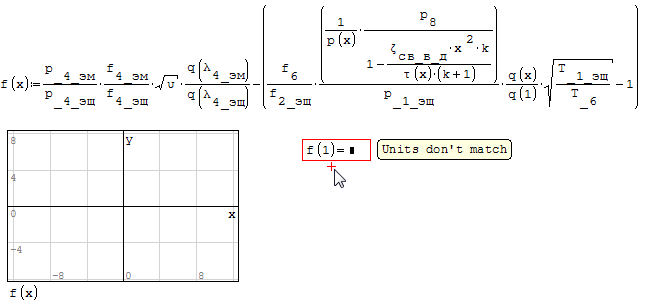

"result above max ..." has no pertinent meaning in your project.
If you attempt "roots" on the numerator only ... "Units don't match"
No need to go further ... zap the units in the project.
WroteWroteWho has faced such a problem, how can it be solved?
I made a mistake, there should be a solve function, in this place the same error

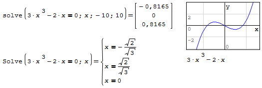

Go on dreaming. If you are in non-linear systems and you can't find a symbolic solution (Maxima's Solve() got stuck when I tried) then you need numerical procedures for solution. These always need an initial guess (Newton-Raphson) or a search region (bisection). The various procedures just differ in how efficient or how robust they are. Some of them may have quite impressive radii of convergence for particular systems but none has infinite radius for all systems.
Furthermore, there remains the problem of uniqueness of a solution. The only solvers in SMath capable of providing multiple solutions are the
- solve() finds all solutions of a single equation within a given range
- Solve() from the Maxima plugin, which finds symbolic solutions.
Blatt21.sm (5.23 KiB) downloaded 588 time(s).
WroteFurthermore, there remains the problem of uniqueness of a solution. The only solvers in SMath capable of providing multiple solutions are the

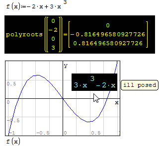

Quite right and not enough wrt complex roots.
Cubic solver Exercise.sm (38.97 KiB) downloaded 608 time(s).

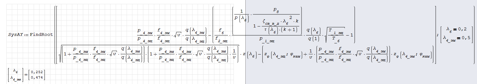

The system looks ill posed, visit Solve Lecture last 3 days.
Poverochnyjj raschjot ehzhektora [solve, spline].sm (104 KiB) downloaded 524 time(s).
... maybe we can leave it as such ... cleanup ?
Poverochnyjj raschjot ehzhektora [solve, spline].sm (110.44 KiB) downloaded 495 time(s).
