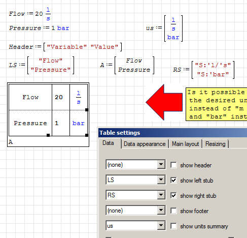

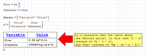

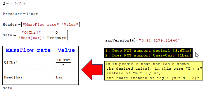

Will it be possible?
Table_Units.sm (9.37 KiB) downloaded 1143 time(s).
Carlos
#2 Posted: 2018/3/7 14:41:34
1,355 likes in 2,271 posts.
Tne solution isn't smart at all but it is possible. Would be half the trouble, if one could store and use the unit in the unit summary vector "us" as they are defined (prevent symbolic processing, which even can't be suppressed when setting optimization to none).
Table_Units_Kr.sm (11.31 KiB) downloaded 1182 time(s).

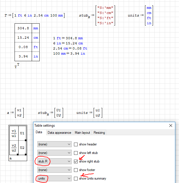

#3 Posted: 2018/3/7 15:11:23
CBG
CBG
78 likes in 312 posts.
Thank you very much Martin,
But now how do I include the header?
since it does not appear as an option in the heading list.
Carlos
#4 Posted: 2018/3/7 16:31:35
Carlos
The header can only be specified for the columns of the data matrix, thus only single column objects are listed as choices for header variable. I don't know of options to fill the fields above the left and right row titles.

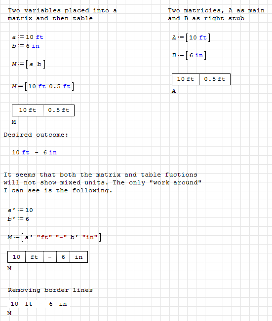

#8 Posted: 2018/6/18 21:21:58
26 likes in 155 posts.
on the topic of units within the table, would the following be possible:
a:= ft
b:= in
matrix:=[a "-" b]
table:= matrix
Show a and b in a table with their corresponding units (ft and inches respectively)
Right now, a and b are shown as default unit only. Both are the same unit.
Why you may ask? This is an attempt at showing mixed units as a single output result in sheet. Often lengths are specified in feet + fractional inches.

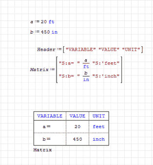

#9 Posted: 2018/6/18 22:30:22
CBG
CBG
Something like this?
Table_Matrix.sm (8.11 KiB) downloaded 1131 time(s).
Best Regrads
Carlos

#11 Posted: 2018/6/19 13:11:25
CBG, The idea is to show mixed units as single linear output.
Mixed Units Ideas - Table.sm (25.34 KiB) downloaded 1088 time(s).
#12 Posted: 2018/6/19 13:39:04
CBG
CBG
Mixed Units Ideas - Table_R1.sm (38.79 KiB) downloaded 1096 time(s).
Carlos
#13 Posted: 2018/6/19 13:48:06
Carlos,
Adding the "S:" makes it look much better.
Maybe at some point, the table region will allow for mixed units. For the time being this solution will work well.
thanks for the input.
Wes

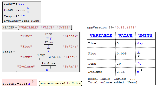

#15 Posted: 2018/6/27 13:22:20
Carlos,
The "unit summary" function of the table region will actually perform the unit conversions for you.
Note that this is only for direct scalar multiplier conversions. It does not work for temp units...
This way you don't have to cancel out units in the matrix going into the table. The "units summary" will do that for you.
Note that the "unit summary" is selected but NOT displayed. There is also a proof with variables.
This idea comes from user ndtma on the Table Region topic, at least that's where i saw it first, maybe someone else did it first?

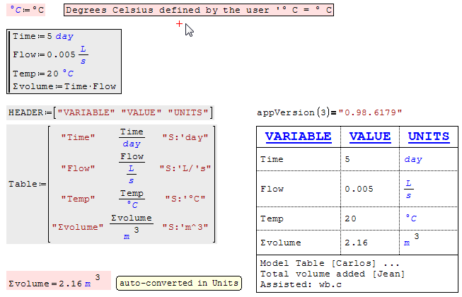

#16 Posted: 2018/6/27 14:09:34
... doctored for °C. Very convenient for me, up2next !
Table Region Carlos.sm (10.81 KiB) downloaded 1131 time(s).
#17 Posted: 2018/6/27 14:31:56
Jean,
"S:'L/s" should be "S:'L/'s". Note the added "'" in order to show "s" as blue unit.
#18 Posted: 2018/6/27 19:47:27
Jean,
Thanks for that one wb.c ... corrected !

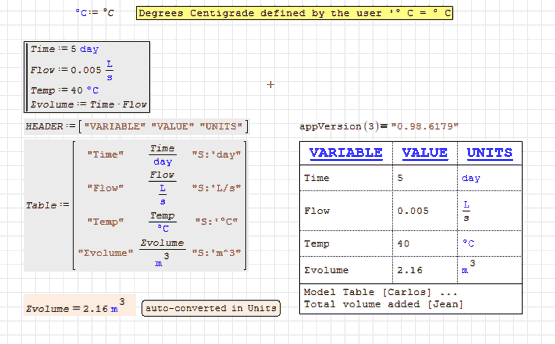

Hi Jean:
A very simple solution for the problem of the conversion of the temperature in Celsius Degrees, is that you define
your own unit of degrees Celsius.
Table Region Carlos_Jean_R1.sm (11.7 KiB) downloaded 1175 time(s).
frapuano 2018/6/29 04:39:00, NDTM Amarasekera 2018/6/29 04:46:00
#20 Posted: 2018/6/29 08:32:39
Hi Jean:
Thanks Carlos for that one.
Thanks to all Doctors ... Nice for publishing.
Table Region Carlos.sm (12.15 KiB) downloaded 1122 time(s).
