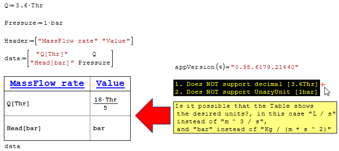

CBG

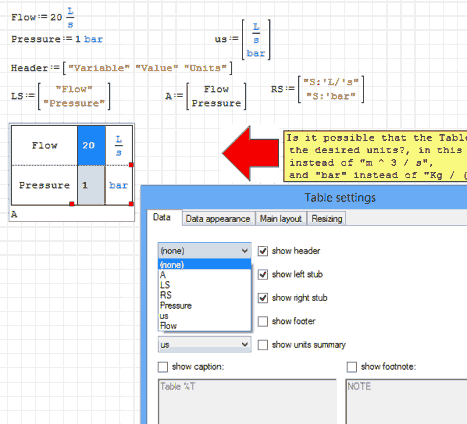

Will it be possible?
Table_Units.sm (9,37 КиБ) скачан 1218 раз(а).

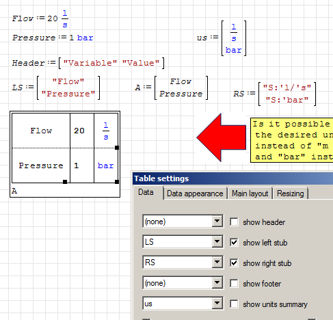

#2 Опубликовано: 07.03.2018 14:41:34
Tne solution isn't smart at all but it is possible. Would be half the trouble, if one could store and use the unit in the unit summary vector "us" as they are defined (prevent symbolic processing, which even can't be suppressed when setting optimization to none).
Table_Units_Kr.sm (11,31 КиБ) скачан 1248 раз(а).

Thank you very much Martin,
But now how do I include the header?
since it does not appear as an option in the heading list.
Carlos
#4 Опубликовано: 07.03.2018 16:31:35
Carlos
The header can only be specified for the columns of the data matrix, thus only single column objects are listed as choices for header variable. I don't know of options to fill the fields above the left and right row titles.

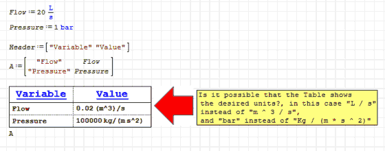

#5 Опубликовано: 07.03.2018 21:35:17
Unit system [base SI in Smath] is desperately too circular.
Table_Units(1).sm (9,87 КиБ) скачан 1216 раз(а).

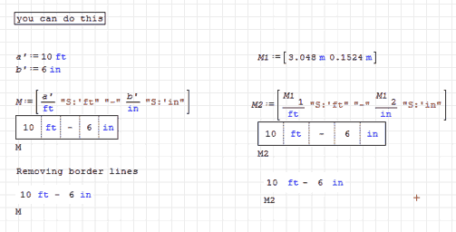

#8 Опубликовано: 18.06.2018 21:21:58
26 сообщений из 155 понравились пользователям.

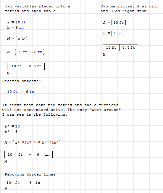

on the topic of units within the table, would the following be possible:
a:= ft
b:= in
matrix:=[a "-" b]
table:= matrix
Show a and b in a table with their corresponding units (ft and inches respectively)
Right now, a and b are shown as default unit only. Both are the same unit.
Why you may ask? This is an attempt at showing mixed units as a single output result in sheet. Often lengths are specified in feet + fractional inches.
#9 Опубликовано: 18.06.2018 22:30:22
CBG
CBG

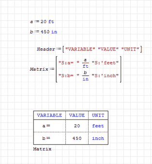

Something like this?
Table_Matrix.sm (8,11 КиБ) скачан 1204 раз(а).

#10 Опубликовано: 19.06.2018 11:39:56
Ruben Sidranski
Ruben Sidranski
Carlos,
Some Jedi magic I don't understand in your sheet.
1) Where did you get the "S colon" {S:} as part of the variable? I don't remember seeing this command/function and don't understand it's use
2) How did you display Matrix (Table)? Most Matrices use the augment command to generate the table. It's not like you typed in Matrix= ... Found this answer, never used it Ctrl+Shift+T
3) Is this a true matrix that was created? Looks like just a data display table. Cannot use the values short of using the variables a or b
Thank you

CBG, The idea is to show mixed units as single linear output.
Mixed Units Ideas - Table.sm (25,34 КиБ) скачан 1149 раз(а).

Carlos,
Adding the "S:" makes it look much better.
Maybe at some point, the table region will allow for mixed units. For the time being this solution will work well.
thanks for the input.

#14 Опубликовано: 19.06.2018 17:20:36
CBG
CBG
Hello ElSid
1).-The "S: '" is to be displayed as a unit in blue, and I learned it from Martin Kraska.
3).-It is the table region, which calls the variable matrix with the name.
Carlos

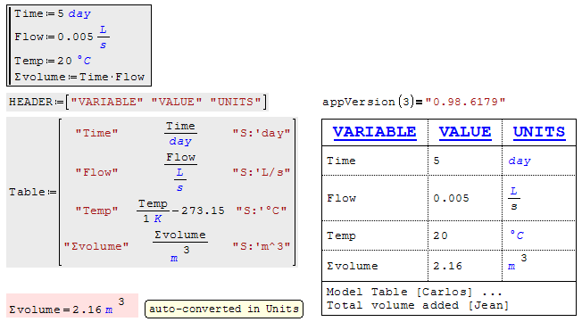

#15 Опубликовано: 27.06.2018 13:22:20
Carlos,

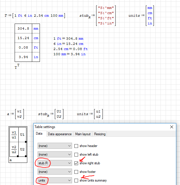

The "unit summary" function of the table region will actually perform the unit conversions for you.
Note that this is only for direct scalar multiplier conversions. It does not work for temp units...
This way you don't have to cancel out units in the matrix going into the table. The "units summary" will do that for you.
Note that the "unit summary" is selected but NOT displayed. There is also a proof with variables.
This idea comes from user ndtma on the Table Region topic, at least that's where i saw it first, maybe someone else did it first?
#16 Опубликовано: 27.06.2018 14:09:34

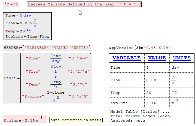

... doctored for °C. Very convenient for me, up2next !
Table Region Carlos.sm (10,81 КиБ) скачан 1198 раз(а).

"S:'L/s" should be "S:'L/'s". Note the added "'" in order to show "s" as blue unit.

Thanks for that one wb.c ... corrected !
#19 Опубликовано: 28.06.2018 23:57:51
CBG
CBG

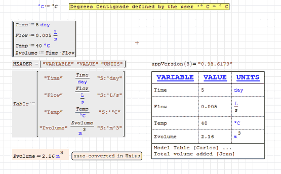

A very simple solution for the problem of the conversion of the temperature in Celsius Degrees, is that you define
your own unit of degrees Celsius.
Table Region Carlos_Jean_R1.sm (11,7 КиБ) скачан 1251 раз(а).

#20 Опубликовано: 29.06.2018 08:32:39
Hi Jean:
Thanks Carlos for that one.
Thanks to all Doctors ... Nice for publishing.
Table Region Carlos.sm (12,15 КиБ) скачан 1191 раз(а).
