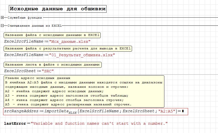

#40 Posted: 2019/1/29 02:10:02
Mikka
Mikka
36 likes in 206 posts.
Hello, stopped working import from xlsx file.
lastError = " Variable and function names can't start with a number. File attached
test.sm (7.14 KiB) downloaded 1309 time(s).
