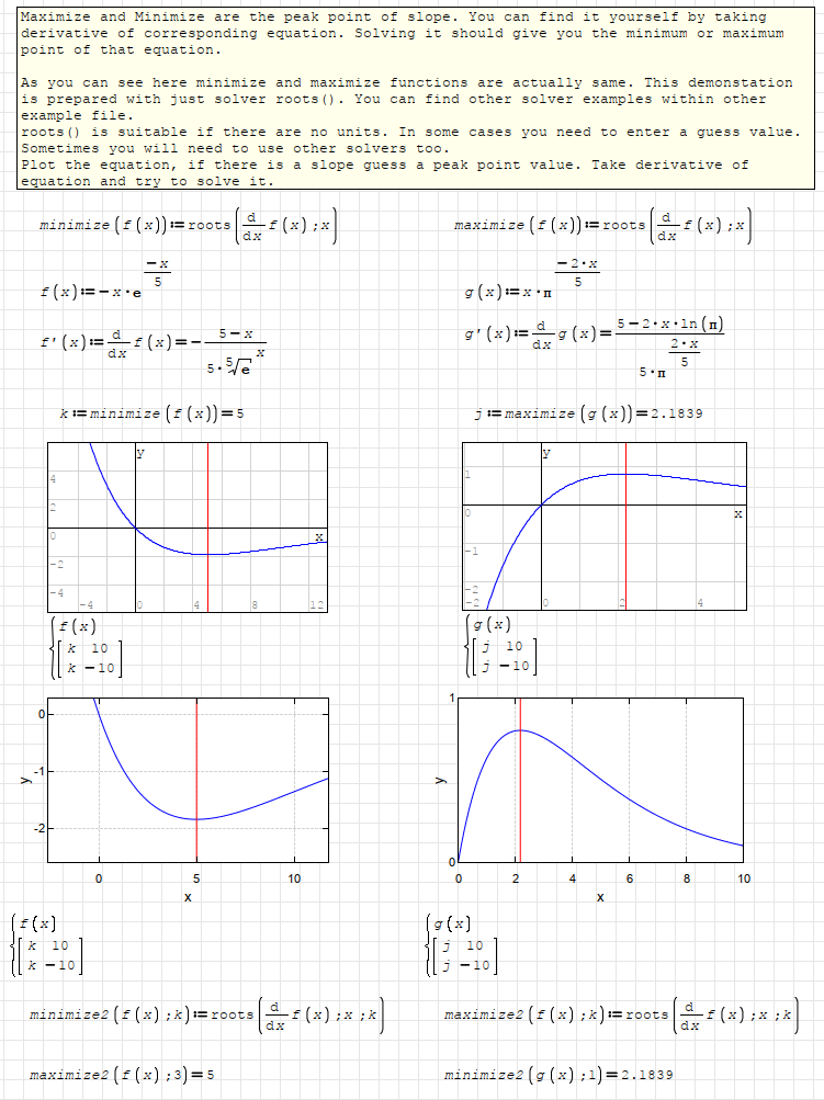

You can write your own functions.
maximize and minimize are peak points of slope.
Take derivative of equation, solve it.
Check the examples below.
maximize_minimize.sm (16.48 KiB) downloaded 1062 time(s).
maximize_minimize with different solvers.sm (28.5 KiB) downloaded 1062 time(s).

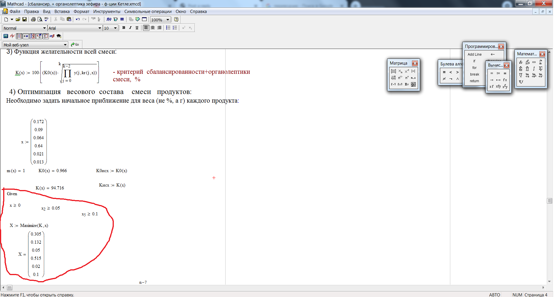

I have a program in MathCad,the problem is that the marshmallow recipe is being optimized here,
I need a maximization function to find the maximum value of each ingredient.
sbalansir. + organoleptika zefira - f-cii Ketle.xls (21 KiB) downloaded 691 time(s).
the exel file contains the values ​​of each marshmallow component that are used in the task.
sbalansir. + organoleptika zefira - f-cii Ketle.xmcd (250.52 KiB) downloaded 1073 time(s).
The whole problem is that the function K(x) is six-dimensional and there is no idea how to find its derivatives.
I need to do the same in Smath Studio, but there are no Given / Maximize / Minimize functions in Smath,
I don't know how to implement this.

Thanks for your feedback , but I need to calculate maximize from the function K(x),
not from y(j, x).
Check this pdf Mathcad file:
Mathcad - sbalansir. + organoleptika zefira - f-cii Ketle.pdf (245.08 KiB) downloaded 612 time(s).
After the function K (x), the vector x is given as the initial approximation
and after that the Given and Miximize functions are used for the K(x) function.
I need to get vector X in Smath.
p.s sorry for my bad eng

That is a total different solver. Smath don't have it integrated.
Maple software has it as Maximize() and Minimize() but plugin doesn't parse it under linux.
At least I couldn't do it with maple plugin.
Maxima can solve that kind of equations with maximize_lp() and minimize_lp().
You have to load(simplex) before using this two functions.
Maybe maxima plugin could work but I can't try it, need a windows user to try it.
I use maxima under terminal, maxima plugin doesn't work with linux.
Regards.

but the main question was how to get this vector X without the Given and Maximize functions,
because it's obtained from these functions: "X: = Maximize (K, x) ?
The bloc solver Given ... Find, Minerr, Maximize, Minimize
is Mathsoft proprietary specific to Mathcad. No such equivalent Smath.
Given/Minerr for fitting model function to data set is done otherwise
in Smath via Conjugate Gradient ... same or even better.
If there is another way of doing in Smath, expect Designers to help.
Sorry Collab, can't help directly on that ... Jean.

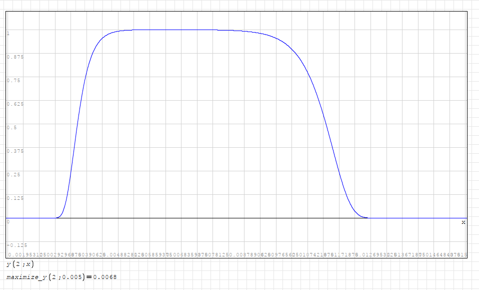

I tried to do this for a simple function through the "roots" function, and in the end I found the maximum,
finding the maximum for a simple function.sm (12.91 KiB) downloaded 1058 time(s).
but there are no ideas how to do this for K (X), since it depends on 6 arguments of the vector x.
Is it possible to somehow implement the same algorithm in my task?
