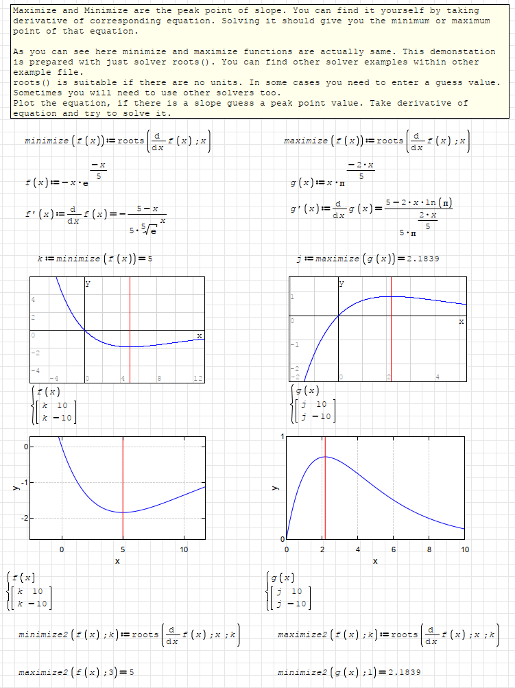

You can write your own functions.
maximize and minimize are peak points of slope.
Take derivative of equation, solve it.
Check the examples below.
maximize_minimize.sm (16.48 KiB) downloaded 1224 time(s).
maximize_minimize with different solvers.sm (28.5 KiB) downloaded 1227 time(s).

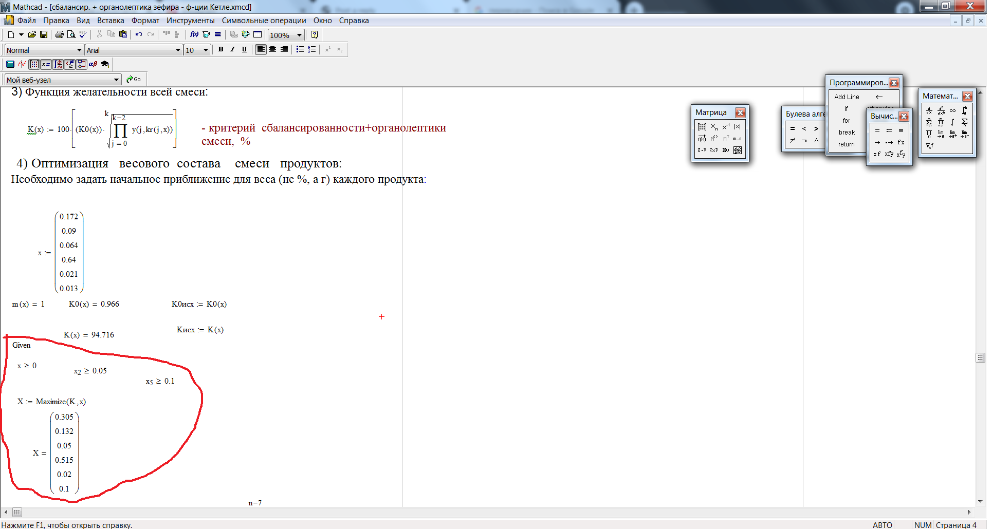

I have a program in MathCad,the problem is that the marshmallow recipe is being optimized here,
I need a maximization function to find the maximum value of each ingredient.
sbalansir. + organoleptika zefira - f-cii Ketle.xls (21 KiB) downloaded 859 time(s).
the exel file contains the values ​​of each marshmallow component that are used in the task.
sbalansir. + organoleptika zefira - f-cii Ketle.xmcd (250.52 KiB) downloaded 1275 time(s).
The whole problem is that the function K(x) is six-dimensional and there is no idea how to find its derivatives.
I need to do the same in Smath Studio, but there are no Given / Maximize / Minimize functions in Smath,
I don't know how to implement this.

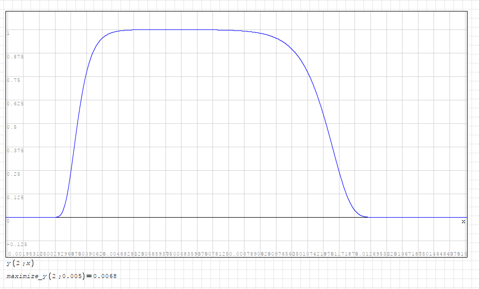

Here is the first solution for your graphics. Rest are in the example.
This is an ugly and fast solution compiled in a haste.
I am pretty sure someone in the forum will come with a more classy method.
diplomnayaRabota_rev.sm (40.34 KiB) downloaded 1193 time(s).

Thanks for your feedback , but I need to calculate maximize from the function K(x),
not from y(j, x).
Check this pdf Mathcad file:
Mathcad - sbalansir. + organoleptika zefira - f-cii Ketle.pdf (245.08 KiB) downloaded 736 time(s).
After the function K (x), the vector x is given as the initial approximation
and after that the Given and Miximize functions are used for the K(x) function.
I need to get vector X in Smath.

Thanks for your corrections , but the main question was how to get this vector X without the Given and Maximize functions,
because it's obtained from these functions: "X: = Maximize (K, x) ?
That is a total different solver. Smath don't have it integrated.
Maple software has it as Maximize() and Minimize() but plugin doesn't parse it under linux.
At least I couldn't do it with maple plugin.
Maxima can solve that kind of equations with maximize_lp() and minimize_lp().
You have to load(simplex) before using this two functions.
