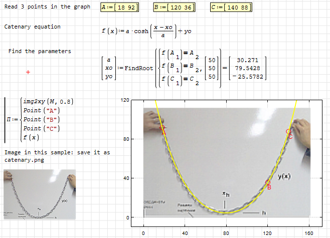

Hi Valery. You can try this.
img2xy-catenary.sm (2.19 MiB) downloaded 1458 time(s).
Davide Carpi 2024/9/26 01:26:00, Valery Ochkov 2024/9/26 01:45:00

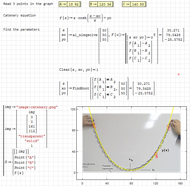

Thanks. I know it, but the question was not about y(X), but al_nl****
#5 Posted: 2024/9/26 04:36:41
1,123 likes in 1,795 posts.
... the question was not about y(X), but al_nl****
Hi. Using the new functionality of XYPlot:
Image with size 161x112:
Smath file: img-catenary-al_nleqsolve.sm (19.15 KiB) downloaded 1349 time(s).
