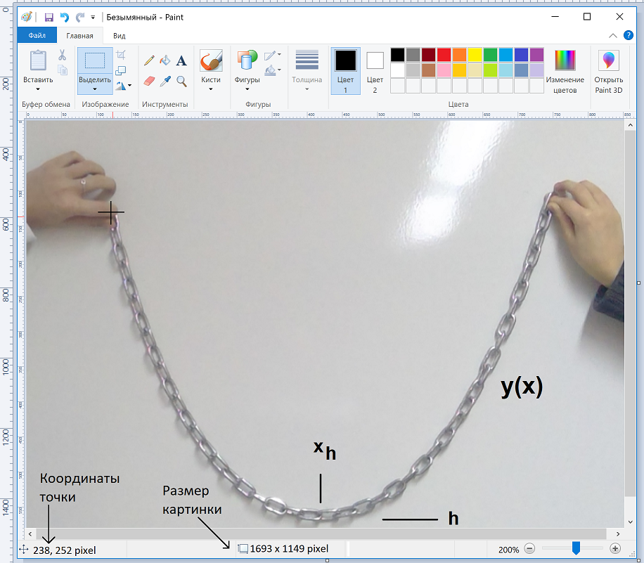

How to use here the al_nl plugin?
Catenary-Photo-an_nl.sm (1,2 МиБ) скачан 1681 раз(а).

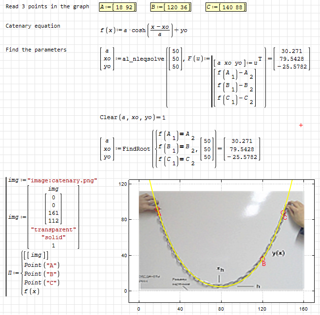

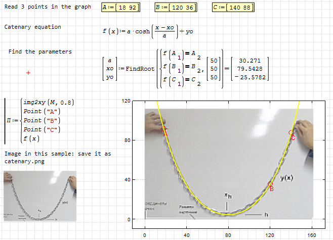

Hi. Using the new functionality of XYPlot:
Image with size 161x112:
Smath file: img-catenary-al_nleqsolve.sm (19,15 КиБ) скачан 1519 раз(а).
