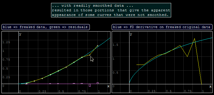

Hello Nicolas,
This is as far as can do from your data. They aren't so nicely collected
as you pretended. Some models will do as well but can fit "Genfit" Smath.
Please: comment ... Jean
Page19 Nicolas Interpolation.sm (50.99 KiB) downloaded 1298 time(s).
... you may prefer this polyfit model ?
Page22 Nicolas Other Fit_Interpolate.sm (27.55 KiB) downloaded 1172 time(s).
Best regards Jean Giraud.
There are many ways to approach engineering. There are researchers in engineering issues, who usually do projects that have input data, vectors or data matrix results directly from lab measurements. These data are smoothed even by the project that these researchers accomplish and are then collected and edited in special books, called engineering design guidelines. There are then design engineers who use those design guidelines with readily smoothed data. Their project input data will then be processed by interpolation from the existing tables in these design guidelines. There are then applicant engineers, who read the projects made by designers and translate them into engineering products in the process of technological processing. The list can continue. I did not work in research, but I'm part of the second category. So let's clear the problem. All the arrays in my examples represent the magnetization curves of some magnetic materials, with certain preset parameters. The graphs provided by you are not relevant, as I have used interpolation, linear interpolation. At the same time, to simplify the vectors and data matrix used for interpolation, they were introduced into the project as discrete values having intervals (where the curve has a more linear shape) where the data is more distant from each other than in the curvilinear portions. Cumulating the effects of how matrix values are entered with the fact that I used a linear interpolation rather than a non-linear (cubic, logarithmic, etc.) resulted in those portions you presented that give the apparent appearance of some curves that were not smoothed. I hope the problem is understood and we will not discuss in the future the issue.
