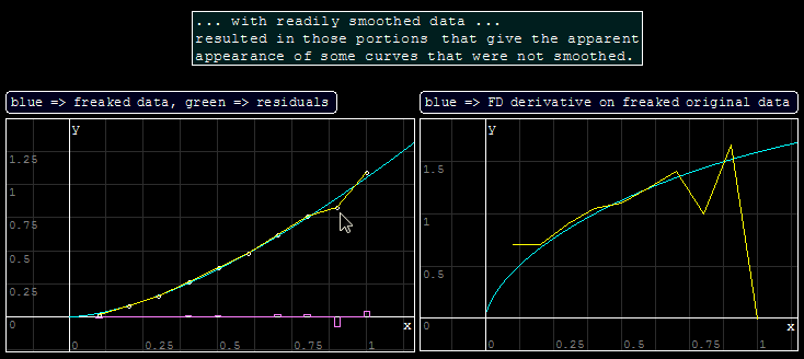

#22 Posted: 12/4/2017 10:00:53 PM
WroteWaiting for a vector of data ...
Three tings here: from very quick
1. a polynomial fit
2. Grow2 model
3. power model
One way or another, you have to do for each column
then populate for more data points, compose the matrix,
from the smmoothed matrices, proceed like before to interpolate
within the matrices ...
Not a big job for me, please do not hesitate: YES/NO

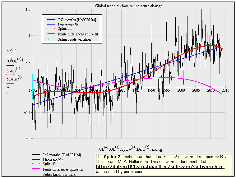

Smoothing is a rescue tool when no fitting method
is productive [model global, model piece wise ...].
1000's of data sets got well done Mathsoft Collaboratory.
I'm just addict to data.
Cheers, all the best.
