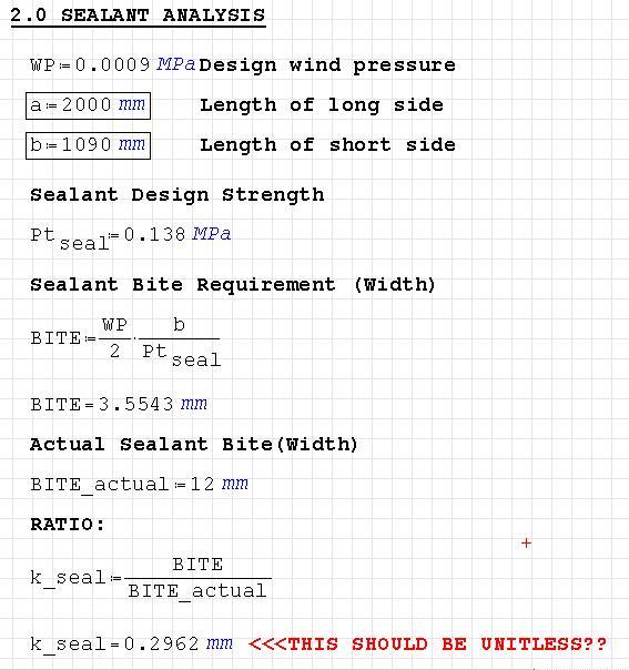

when similar units are divided the result does not cancel the unit
please help and see attached file.
thanks and more power to SMATH!

Thanks Omorr! already attached the jpeg on my 1st post.
Maxx

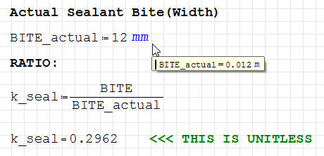

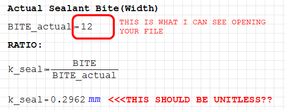

Hi megamaxx,
you have forgot the unit in the BITE_actual definition (see the attachment)
regards,
w3b5urf3r

#6 Posted: 2012/8/11 13:41:10
I tried your example and got the unitless value, as it should be.
Could you attach your *.sm file, please.
#7 Posted: 2012/8/11 13:44:48
1,443 likes in 2,935 posts.
megamaxx
from wath I can see from your *.sm file, you simply forgot the unit in BITE_actual (see the attachments), but I can't reproduce the issue in your image...

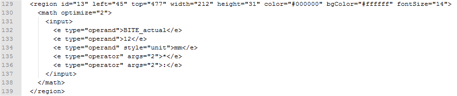

#9 Posted: 2012/8/12 03:22:04
Hi
I can't replicate the issue but now I can confirm that there is something strange
In the attachments there are:
1) the source of your file as downloaded
2) the source of your file opened by SMath studio and saved on my PC
3) the correct source
I do not know how did your SMath create the script:
mm
regards,
w3b5urf3r

#10 Posted: 2012/8/12 15:35:18
2,340 likes in 4,041 posts.
Many thanks for the bug report and for troubleshooting!
I've reproduced a bug. See animation for details. Wil fix this.
Best Regards.
