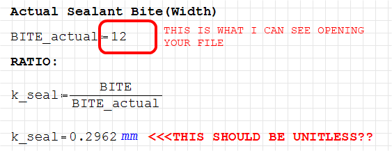

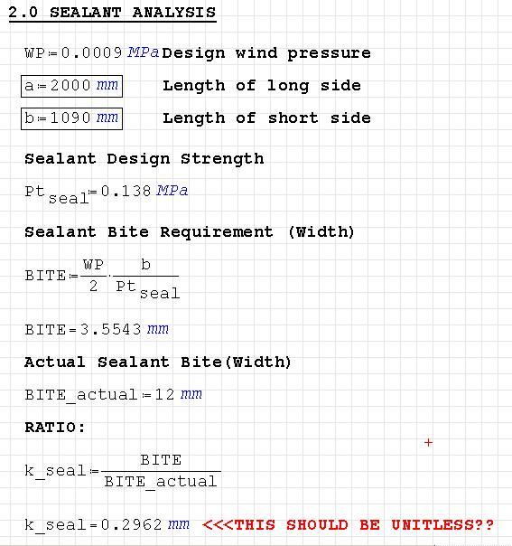

when similar units are divided the result does not cancel the unit
please help and see attached file.
thanks and more power to SMATH!
megamaxx

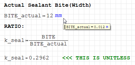

Hi megamaxx,
you have forgot the unit in the BITE_actual definition (see the attachment)

I tried your example and got the unitless value, as it should be.
Could you attach your *.sm file, please.

from wath I can see from your *.sm file, you simply forgot the unit in BITE_actual (see the attachments), but I can't reproduce the issue in your image...

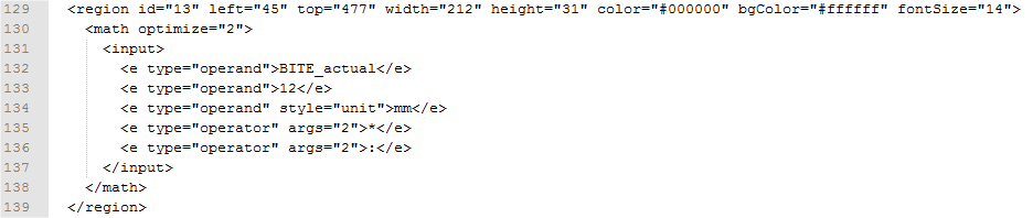

#9 Опубликовано: 12.08.2012 03:22:04
Hi
I can't replicate the issue but now I can confirm that there is something strange
In the attachments there are:
1) the source of your file as downloaded
2) the source of your file opened by SMath studio and saved on my PC
3) the correct source
I do not know how did your SMath create the script:
mm
regards,

#10 Опубликовано: 12.08.2012 15:35:18
2 343 сообщений из 4 055 понравились пользователям.
Группа: Super Administrator
Many thanks for the bug report and for troubleshooting!
I've reproduced a bug. See animation for details. Wil fix this.
