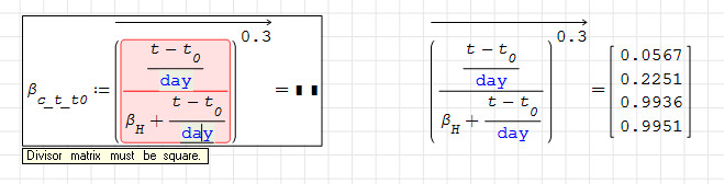

SMath Forum SMath Studio Questions Why vecterize function doesn't work 1 Pages (2 items) Why vecterize function doesn't work - Messages Go to last post #1 Posted: 2025/3/8 21:56:34 netsonicyxf 2 likes in 79 posts. Group: User The vecterize function doesnt't work on the left, but it works on the right side.Prestress Tension Loss Verification as per EN 1992.sm (25.09 KiB) downloaded 1586 time(s). #2 Posted: 2025/3/8 23:08:57 sergio 127 likes in 342 posts. Group: User In such cases it can be solved by inserting the operation in a "line" which calculates the values before assigning them Show Spoiler sergio 2 users liked this postchurichuro 2025/3/9 02:56:00, netsonicyxf 2025/3/9 09:27:00 1 Pages (2 items) New Posts No New Posts
