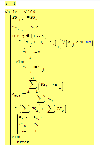

while loop repeats itself as long as the condition (1st argument) it's true. So you need that it's true before the loop starts to run it at least once AND a modifier inside the loop to change it when some criterion is met.
In your example, you migth implement it like this:
![2021-03-25 14_02_55-SMath Studio - [while loop.sm_].png](/zh-Hans-CN/files/Download/54Qqsh/2021-03-25-14_02_55-SMath-Studio---[while-loop.sm_].png)

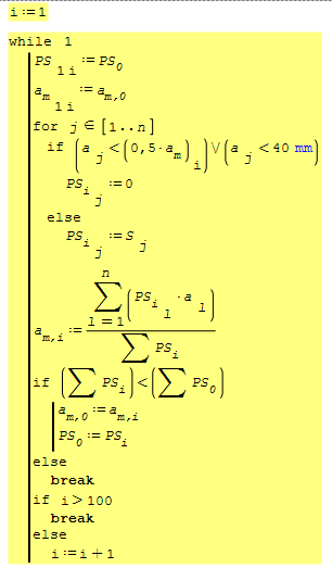

you can even move the i<100 check inside an infinite loop loop
![2021-03-25 14_11_50-SMath Studio - [while loop.sm_].png](/zh-Hans-CN/files/Download/bHkzBx/2021-03-25-14_11_50-SMath-Studio---[while-loop.sm_].png)
Davide,
Thank you for the suggestion. The condition for continuing the loop should be (sum(PS.i))<(sum(PS.0)).
For this kind of iteration, does one make more sense over the other?

When working with while you have to focus mainly on how to stop the loop. If there is always a convergence, then you are fine. But if you get stuck in an infinite loop the program might crash. So be careful if you plan to not cap the number of iterations.
