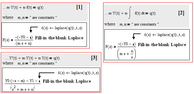

Number of ODE's have symbolic solution.
If your DE has either of these tree forms,
Smath will spits scalar solutions wrt parameters/IC ...

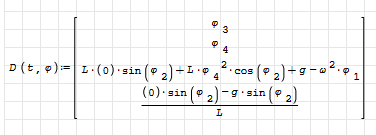

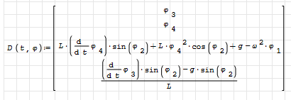

However, notice that since the values of phi are numbers and not expressions, you cannot compute the derivatives of its components the way you do in D. You can check this by substituting zero for its values, and you get the same numerical solutions.
For diff(el(φ,3),t) you can use el(φ,4), and for diff(el(φ,4),t) you should use some kind of numerical estimate.

Hi Oichi. Not. Remember that given F(x,x',x'',...,t) = 0 then for using numerical DEs solvers you must to find the system D(t,x) = [x', x'', ... ] with an appropriate change of variables. Which is your original analytic expression of your differential equation to be solved? This is, the one or two equations involving both all derivatives of all "x" variables, F(x,x',x'',...,t) = 0.

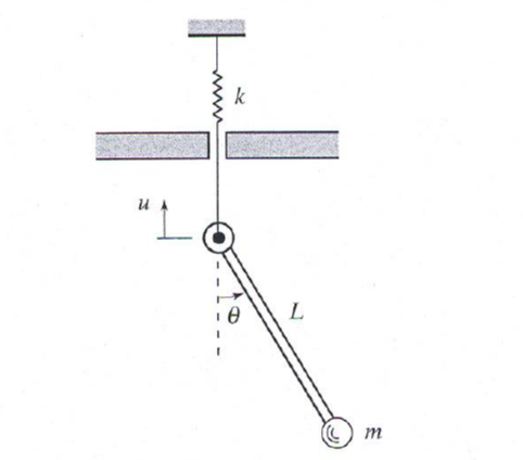

This example is for a pendulum that it's upper end is attached to a spring, The displacement of this upper end is Phi(1) "u" and the angular displacement of the pendulum is Phi(2) "theta". Phi(3) "u_dot" and Phi(4) "theta_dot" are the first derivatives of the upper end vertical motion and the angular displacement of the pendulum respectively.
