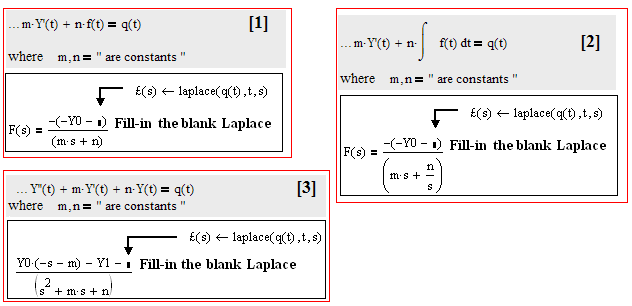

Number of ODE's have symbolic solution.
If your DE has either of these tree forms,
Smath will spits scalar solutions wrt parameters/IC ...
One of my old baby in Mathsoft Collaboratory.
Cheers ... Jean.

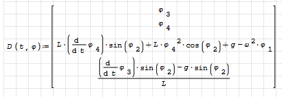

#13 Posted: 2/4/2023 10:45:29 AM
This version is doctored for SS versions as low as SS 6179.
To make it compatible with ODE universal plugins.
Can you update my invented vector 'phi' in red
So that the system makes sense for all visitors.
Cheers ... Jean.
Vibrating Pendulum (1).sm (24.56 KiB) downloaded 1237 time(s).

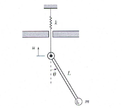

This example is for a pendulum that it's upper end is attached to a spring, The displacement of this upper end is Phi(1) "u" and the angular displacement of the pendulum is Phi(2) "theta". Phi(3) "u_dot" and Phi(4) "theta_dot" are the first derivatives of the upper end vertical motion and the angular displacement of the pendulum respectively.

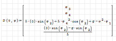

I did a trick and removed the d/dt terms.. but now I got a new problem. The Adams function telling me "Cannot calculate"
Vibrating Pendulum 2.sm (107.61 KiB) downloaded 1266 time(s).
#16 Posted: 2/4/2023 3:21:26 PM
Thanks for explaining your advanced project.
Up until now, I can only manage the homogeneous Pendulum.
Cheers ... Jean.

Hi. The attached file uses the techniques shown here and here. You can also obtain the equations of motion using the lagrangian with what is shown here.
Vibrating Pendulum.sm (116.24 KiB) downloaded 1284 time(s).
Vibrating Pendulum.pdf (183.21 KiB) downloaded 740 time(s).
