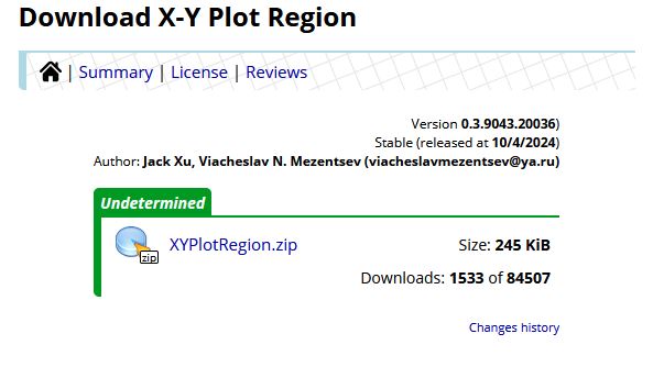

#7 Posted: 2024/10/30 23:31:50
1,554 likes in 1,864 posts.
Is this what you mean?
Yes.
The problem may be related to the fact that you don't have the required version of .Net Framework installed. Usually the current version is sufficient, but the component itself is developed using an older version (.Net Framework 2.0). Try checking or installing version .Net Framework 2.0 or 3.5 for Windows 11.
It's strange that the component worked on the same machine before. Others have no problem because they are most likely running older versions of operating systems or have the required versions of the .Net Framework.

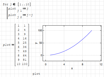

#8 Posted: 2024/10/30 23:58:07
1,443 likes in 2,935 posts.
No problems here as well.
XYplot.sm (9.88 KiB) downloaded 1605 time(s).
If you install the development tools plugin, in the "Insert" > "Development tools" > "System informations" dialog you can retrieve all the relevant framework and system information.
