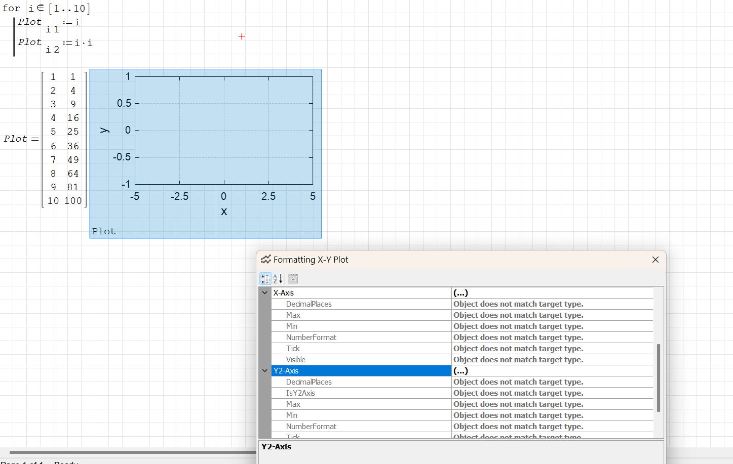

I have just tried to use Smath, after a break of two or three months. I can't get the x-y Plots to work. When I try to adjust the scales, etc, from the defaults, I get the message "object does not match target type" in most/all sections.
I checked with an older file that used x-y Plots - the plots displayed properly, but I still got the same messages when I tried to access the scales, etc.
When I launched Smath yesterday I was offered a new, updated version - I accepted - was this a mistake, has something changed?
Any help would be gratefully accepted.

#4 Posted: 10/30/2024 8:26:32 PM
Very interesting. What operating system, SMath Studio version and X-Y Plot version?
Yes, there has been some updating, but no such side effects have been observed yet.

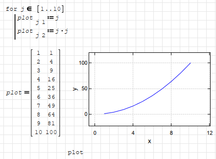

#8 Posted: 10/30/2024 11:58:07 PM
No problems here as well.
XYplot.sm (9.88 KiB) downloaded 1747 time(s).
If you install the development tools plugin, in the "Insert" > "Development tools" > "System informations" dialog you can retrieve all the relevant framework and system information.

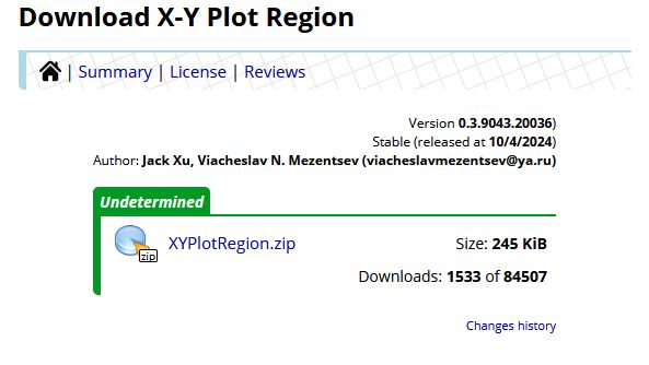

You can install an older version from the list here:
https://smath.com/en-US/view/XYPlotRegion/history
1. Remove the current version of the plugin from the program.
2. Restart the program.
3. Drag the archive with the plugin to the program window with the mouse. This is an alternative installation method.
