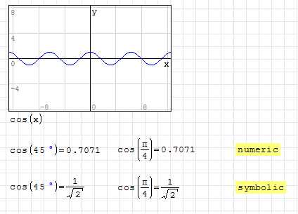

Hi [userlink]Kasperhaack[/userlink]
To show or to customize an output unit you must type the apostrophe on the placeholder in the right side of the equation, and then you can type the unit ° or you can choose one from the list that appear (the dynamic assistance box).
EDIT: see also UNITS ON WIKI

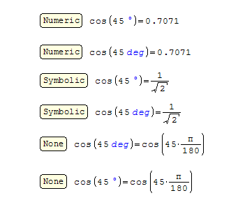

looks like they're back problems with degrees in 0.96.4875 version.
such as "cos (45°)" does not work in numeric mode
works for me (win7 x64)
