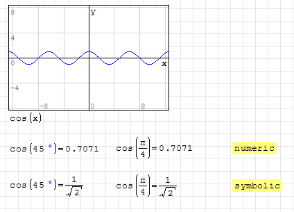

Hi [userlink]Kasperhaack[/userlink]
To show or to customize an output unit you must type the apostrophe on the placeholder in the right side of the equation, and then you can type the unit ° or you can choose one from the list that appear (the dynamic assistance box).
EDIT: see also UNITS ON WIKI

#6 Posted: 5/8/2013 6:57:58 AM
1,437 likes in 2,920 posts.
looks like they're back problems with degrees in 0.96.4875 version.
such as "cos (45°)" does not work in numeric mode
works for me (win7 x64)

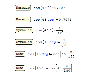

#7 Posted: 5/8/2013 7:11:47 AM
120 likes in 337 posts.
from me no
win7 64
[albumimg]120[/albumimg]
#8 Posted: 5/8/2013 8:05:51 AM
It works for me as well
Win7 - 64
