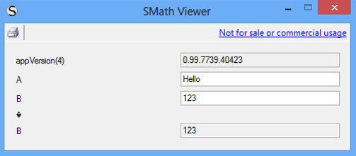

I have a question if it's possible to display the string part of a matrix in *.exe file created from a Smath file?
Screenshot of issue
Tried the var2string function, but after changing the string value via exe file, it reads function argument name (a) instead of it's value.
Is there some kind of workaround for this issue?

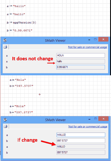

#4 Posted: 2018/6/29 11:27:39
Arie
Arie
94 likes in 285 posts.
Make sure you hit enter/return key after entering value.
Edit: You may have found a bug. This kind of functionality works great with numeric values but not with strings. I've tried with different optimizations as well to no avail.
I'm not sure it's ever worked. I now SMath Viewer is still a work in progress so feel free to add bug entry.

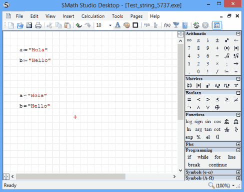

#5 Posted: 2018/6/29 14:33:35
CBG
CBG
78 likes in 312 posts.
Screenshot of issue
Hello Barmin
The function you are looking for was previously available in previous versions of smath, such as version 5737.
I do not know why they disabled it. Here I put an example in that version.
Test_string_5737.zip (359.64 KiB) downloaded 350 time(s).
Carlos

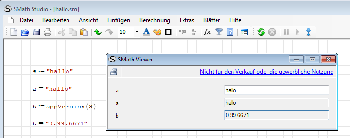

#7 Posted: 2018/7/2 11:07:17
1,355 likes in 2,271 posts.
Can't reproduce
hallo.sm (2.75 KiB) downloaded 1016 time(s).
hallo.zip (482.23 KiB) downloaded 329 time(s).
#8 Posted: 2018/7/2 11:11:51
Arie
Arie
Martin,
Once the Viewer is running try to change the value of Hallo and notice if it doesn't update in the second box.
#9 Posted: 2018/7/2 22:58:56
CBG
CBG
#10 Posted: 2018/7/3 04:58:49

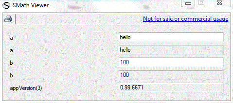

For me it works. Yet I have to press enter to forward the changes in the input box.

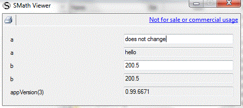

#11 Posted: 2018/7/3 06:14:27
For me it will change the numerical variable but not the string one (with return pressing, of course).
before
after

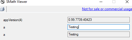

#18 Posted: 2021/3/12 22:08:51
26 likes in 155 posts.
Seems to be working just fine for me.
99.7739.40423_Test_exe.zip (571.28 KiB) downloaded 305 time(s).
Good Luck!

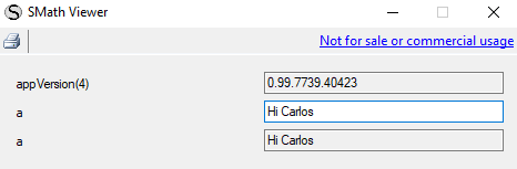

#19 Posted: 2021/3/12 22:12:22
I'm using 64bit Win10 Enterprise by the way. Maybe it matters?
Alvaro 2021/3/12 23:30:00
#20 Posted: 2021/3/12 23:29:48
1,123 likes in 1,795 posts.
Me too, but 32 bits. I'm reinstall SMath and now works fine.
Thanks.
