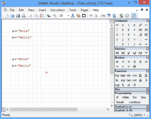

Hello Barmin
The function you are looking for was previously available in previous versions of smath, such as version 5737.
I do not know why they disabled it. Here I put an example in that version.
Test_string_5737.zip (359.64 KiB) downloaded 434 time(s).

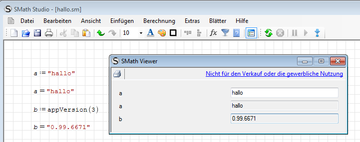

#7 Posted: 7/2/2018 11:07:17 AM
1,361 likes in 2,275 posts.
Can't reproduce
hallo.sm (2.75 KiB) downloaded 1170 time(s).
hallo.zip (482.23 KiB) downloaded 415 time(s).

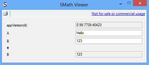

#10 Posted: 7/3/2018 4:58:49 AM
For me it works. Yet I have to press enter to forward the changes in the input box.

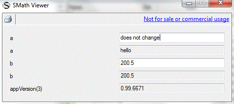

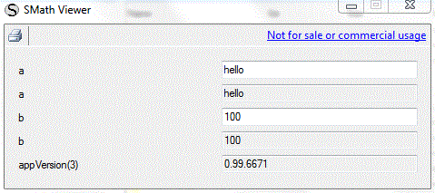

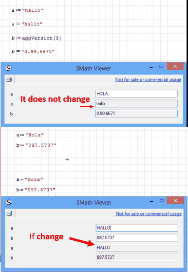

#11 Posted: 7/3/2018 6:14:27 AM
For me it will change the numerical variable but not the string one (with return pressing, of course).
before
after

I did a test with the latest version of Smath Studio and the Viewer and it does not work
Carlos

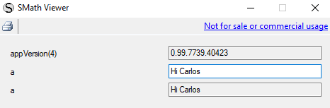

#17 Posted: 3/12/2021 3:03:32 PM
1,139 likes in 1,805 posts.
Carlos
Hi. Carlos it's right. I guess that there are an issue with the automatic update within the nightly build which seems to be now appVersion(4)="0.99.7739.40423"@# but previously I have appVersion(4)="0.99.7739.41xxx "@# or something like that.

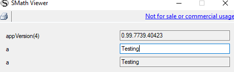

#18 Posted: 3/12/2021 10:08:51 PM
26 likes in 155 posts.
Seems to be working just fine for me.
99.7739.40423_Test_exe.zip (571.28 KiB) downloaded 388 time(s).
Good Luck!
