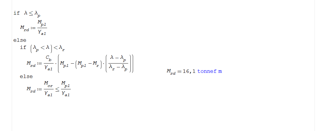

Hello everyone.
I have an If shown in the image below. I would like that in addition to the result of the equation, it would also be shown from which equation the result originated.
It is possible?

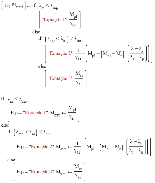

Leandro, for example like this:
Leandro.sm (7.13 KiB) downloaded 1029 time(s).
As Jean says help us get help and always attach the smath file with the problematic example.

Thank´s so much Sergio. It´s Works very nice.
Next time I will put smath file.
Attach the math file only to check my solution. But this is in Portuguese!
Memoria de Calculo Monovia.sm (243.67 KiB) downloaded 995 time(s).

Hi. Those are very similar to the Sergio (Pompelmo Tell) solution:
