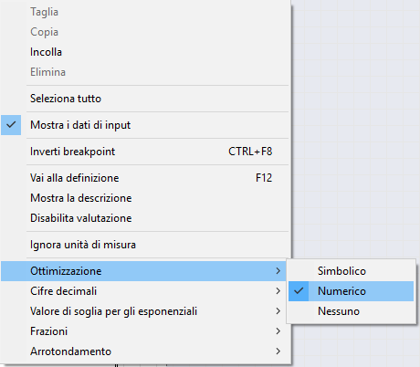

On the other hand, the while loop must be "Numeric" NOT Optimiz
Also, part of the while loop does not like Units.

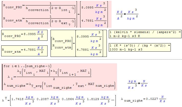

Your Rint 0 generates "division by zero" easy to imagine that Rint may not be exactly 0 ... 10^-12 is very close to 0.
I see that Rint=0 his coming from a modification in the calculation of the internal radius of the first layer of lining; it was Rint[1 in my file, resulting in a non-zero radius.
I see Rint[2 in yours, so first element of the vector is set to zero while second element stores the radius.
Would be wise to work unitless.

I didn't really get a chance to go through the math at all, but I did optimize run time of the current implementation. I used the eval() function in the lamda_t function definition. Took evaluation from 20 seconds to 0.25 seconds on my machine.
PROVA CONDUZIONE TERMICA_bkp_alyles.sm (65.88 KiB) downloaded 1093 time(s).

Is there a way to understand during debugging if and why the units are creating the problem?
I know Jean has an aversion to using the built-in unit system within SMath, but I use it frequently without issue. I've not noticed a decrease in performance when using units vs. defining programs to be unitless. I personally think the use of units in calculation is extremely useful in quickly validating general arithmetic and results. Working with units can sometimes be a pain in the sense that when generating equations/programs you may often run into issues where units don't match (and calculations cannot complete) or end results don't make sense. Again, I find this useful in understanding all the different components of the equations/programs I generate.

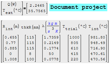

A small modification
Thanks Carlos for doctoring this project.
1. Refreshed a bit
2. Few more things at the end.
3. "L" is confusing as not explained ... considered "unary"
4. Two pests [in green] wrt to units.
5. The last 4 "clear" removed from program [avoid red]
Wait and see for Originator to comment/complement
PROVA CONDUZIONE TERMICA_bkp_CBG [Jean].sm (344.38 KiB) downloaded 963 time(s).
I needed to right click and set the while to Numerical optimization?
Setting my original file this way, makes the loop work quickly (shame on me, I wasn't even aware of such setting...)
Also Alyses hint has helped me to understand that the symbolic evaluation was the problem, and that some different setting should be implemented.

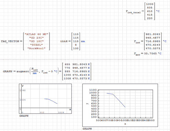

#16 Posted: 2018/6/20 22:03:18
ean, what command are you using to generate this kind of matrix? What is the sintax, I mean,to define Q(w) or T.ext (°c) and obtain results without Units? Looks like it is a Custom Function again.
That, mon ami, is too simple doing ... like this:
1. from the matrix palette, insert a 2 rows by 5 cols
2. in 2nd row, paste results from above results,
backspace on units Rint ... bacspace on all 'm'
3. in 1rst row, type trial(Alt+248C) => trial(°C)
4. λ(,) ... kg*m/s^3*K from result above
This type of matrix project collection is natural, fast
and fully accessible by more maths from other demands.

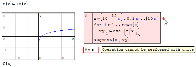

So, in the end, if my understanding is correct, eval() and right-click numeric optimization setting are equivalent, isn't it?
Not so simple !
In the just attached Hermite Polyline, open the first collapsed area.
Observe eval(,) in the subspace module, this is a case of local definition.
#18 Posted: 2018/6/21 13:18:42
... Data Table added. No problem to construct and display.
Couldn't reduce the height of the two first rows ... Ah !
Project PROVA CONDUZIONE TERMICA_bkp_CBG [Jean].sm (402.64 KiB) downloaded 968 time(s).
