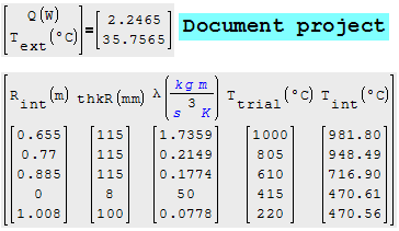

So, I started preparing the attached file.
PROVA CONDUZIONE TERMICA_bkp.sm (62,36 КиБ) скачан 1292 раз(а).
Basic elements of the file are:
* There are four layers of internal refractory (1 to 4)
* Layer 5 is steel
* Layers 6 and 7 are external insulation
* In case a layer is missing, its thickness is set to zero.
* A database o materials is defined, and conductivity is interpolated between known data (supplied by lining fabricators).
The logic behind is:
1) Input general data
2) Select materials and thicknesses
3) Program loops from a trial linear temperature profile, updating conductivities at each loop, since conductivity is a function of temperature itself... that's the reason for looping.
4) Equivalent thermal resistance is calculated
5) Total heat flux is calculated
6) Trial temperature profile is updated backwards...
... or at least, that was my initial goal
I found out that the "while" iterations will take A LOT of memory, even if in my mind this problem seems not so demanding in terms of resources.
This is the reason why the "while" loop is temporarily controlled by a maximum number of iterations.
I wanted to add a numerical residual check, in order to break the "while" when residuals where small enough, but I had to begin debugging, so at the moment i'm using the variable "counterlimit" to stop the loop.
It came out that, with counterlimit set to 3 (or below, but in that case results are not yet good enough..), Smath runs the calculation in 20 sec... If counter is set to 4 or above, it runs for minutes (and I always stop it manually).
This said..... why such increase in execution time? Does anybody understand where am I missing something and why is this calculation so demanding, only if counterlimit is increased?
What bothers me the most, is that calculation time does not increase proportionally with the "while" counter number, even if the dataset is not increase in dimension while iterations proceed...
If somebody is willing to dig a little bit into this file, I will be glad to learn something from some expert user!
Thank you
Ciao!
ps: I can see that the conductivity calculation, as I implemented it, is kind of messy (a matrix of materials made up of vectors, used to interpolate conductivity for each material at each loop).... but honestly speaking I couldn't find a better way to fit conductivity equations into (remarkable!) Davide Carpi Comboboxlist plugin.
I will try to store equations as a string, recall it from the database and cook it back again as a formula with "num2string"... Never tried this approach, but it's worth a test or two.

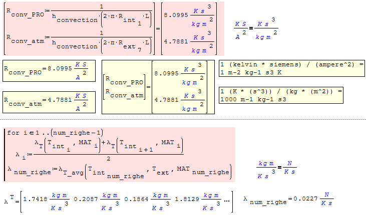

Honestly, I'm lost in there. The project is so messy, it lacks sound preparation.
Your Rint 0 generates "division by zero" easy to imagine that Rint may not be
exactly 0 ... 10^-12 is very close to 0.
On the other hand, the while loop must be "Numeric" NOT Optimiz

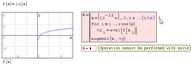

Also, part of the while loop does not like Units.
My Smath version 6179
Would be wise to work unitless.
Will be back ... Jean

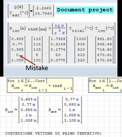

Your Rint 0 generates "division by zero" easy to imagine that Rint may not be exactly 0 ... 10^-12 is very close to 0.
I see that Rint=0 his coming from a modification in the calculation of the internal radius of the first layer of lining; it was Rint[1 in my file, resulting in a non-zero radius.
I see Rint[2 in yours, so first element of the vector is set to zero while second element stores the radius.

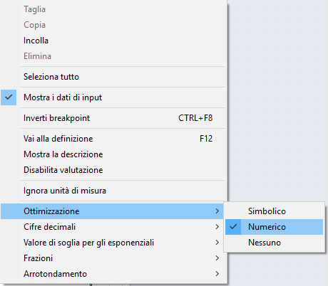

Is there a way to understand during debugging if and why the units are creating the problem?
I know Jean has an aversion to using the built-in unit system within SMath, but I use it frequently without issue. I've not noticed a decrease in performance when using units vs. defining programs to be unitless. I personally think the use of units in calculation is extremely useful in quickly validating general arithmetic and results. Working with units can sometimes be a pain in the sense that when generating equations/programs you may often run into issues where units don't match (and calculations cannot complete) or end results don't make sense. Again, I find this useful in understanding all the different components of the equations/programs I generate.
Work 1rst modular like in the attached.
Most confusing are different but equivalent maths that output different unit system.
What other simple maths will output another/same unit system or "Units don't match".
PROVA CONDUZIONE TERMICA_bkp [0].sm (94,05 КиБ) скачан 1132 раз(а).

Hello Jean
I think there is an error in the internal radios.
Carlos

Hello Jean
Thanks Carlos: my mistake from copy/paste, delete 'm'
Forgot the unit system bug that does not output 0m, 1m.
I needed to right click and set the while to Numerical optimization?
Setting my original file this way, makes the loop work quickly (shame on me, I wasn't even aware of such setting...)

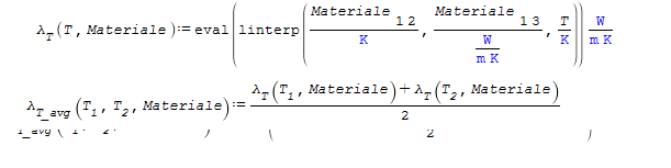

Also Alyses hint has helped me to understand that the symbolic evaluation was the problem, and that some different setting should be implemented.
... I did optimize run time of the current implementation. I used the eval() function in the lamda_t function definition...
Iinfact, the following files by other users did not use the eval() function, so I was kind of lost, until I found that right click setting...
So, in the end, if my understanding is correct, eval() and right-click numeric optimization setting are equivalent, isn't it?

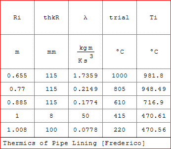

ean, what command are you using to generate this kind of matrix? What is the sintax, I mean,to define Q(w) or T.ext (°c) and obtain results without Units? Looks like it is a Custom Function again.
That, mon ami, is too simple doing ... like this:
1. from the matrix palette, insert a 2 rows by 5 cols
2. in 2nd row, paste results from above results,
backspace on units Rint ... bacspace on all 'm'
3. in 1rst row, type trial(Alt+248C) => trial(°C)
4. λ(,) ... kg*m/s^3*K from result above
This type of matrix project collection is natural, fast
and fully accessible by more maths from other demands.
It has nothing to do with the plugin "Table region"

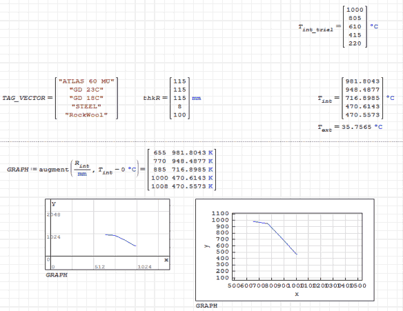

... Data Table added. No problem to construct and display.
Couldn't reduce the height of the two first rows ... Ah !
Project PROVA CONDUZIONE TERMICA_bkp_CBG [Jean].sm (402,64 КиБ) скачан 1137 раз(а).
