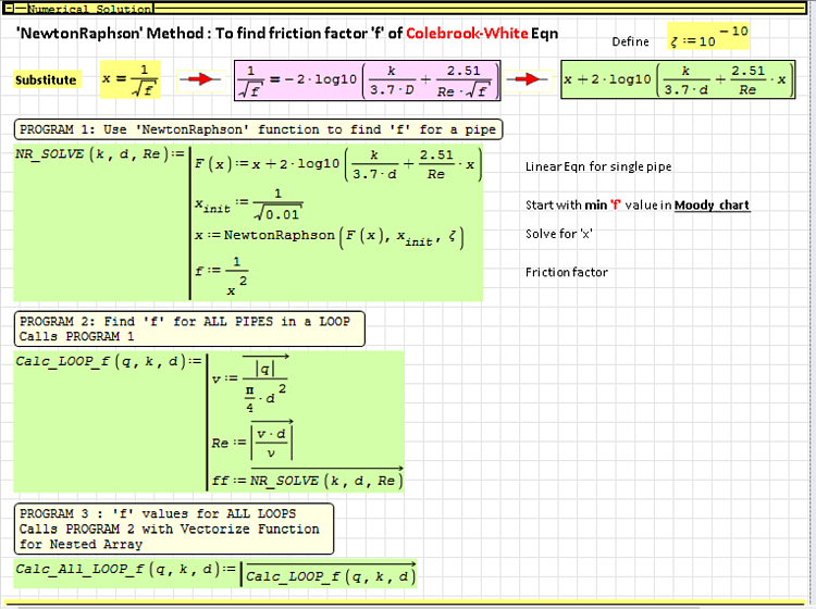

Hardy Cross method revisited.
The friction factor for turbulent flow is calculated using the Colebrook-White equation.
Due to the implicit nature of this equation, calculation of the friction factor requires an iterative solution via numerical methods. Hence, many explicit approximations have been proposed such as Haaland, Moody, Jain etc. to simplify the calculation process.
The attached sm file shows the iterative method of solving the Colebrook-White equation to calculate ONLY the friction factor ‘f’, for use in the Hardy Cross method. The calculated pipe flows were well within the values obtained in my last example.
Cheers.
Colebrook-White-Numerical Soltion.sm (44.21 KiB) downloaded 1337 time(s).
Colebrook-White-Numerical Soltion.pdf (176.14 KiB) downloaded 1172 time(s).
