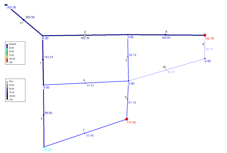

Also, many thanks to Carlos for his example using EPANET which prompted me to check and correct my program.

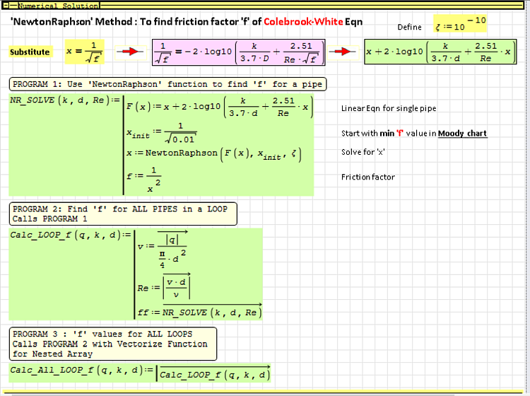

The friction factor for turbulent flow is calculated using the Colebrook-White equation.
Due to the implicit nature of this equation, calculation of the friction factor requires an iterative solution via numerical methods. Hence, many explicit approximations have been proposed such as Haaland, Moody, Jain etc. to simplify the calculation process.
The attached sm file shows the iterative method of solving the Colebrook-White equation to calculate ONLY the friction factor ‘f’, for use in the Hardy Cross method. The calculated pipe flows were well within the values obtained in my last example.
Cheers.
Colebrook-White-Numerical Soltion.sm (44,21 КиБ) скачан 1533 раз(а).
Colebrook-White-Numerical Soltion.pdf (176,14 КиБ) скачан 1321 раз(а).

WroteI am extremely sorry that in my last example on 3 LOOPS, I have made a careless mistake in Program 2 to calculate the appropriate corrections in the network. The results were wrong.
Furthermore, for simplicity, I assumed a fixed friction factor instead of the method given in the original EXCEL file in the web.
The revised SM and EXCEL files are attached. They both tally. The original EXCEL file had only 5 trials and I extended to 10 trials.
