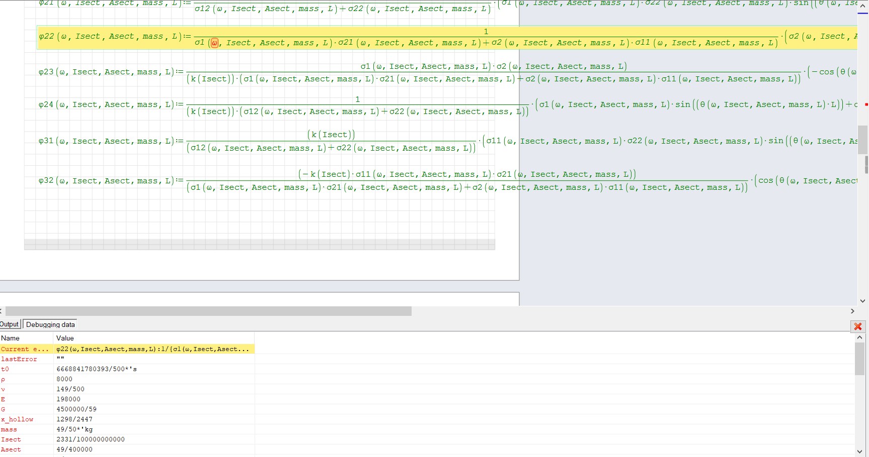

I'm testing the combination of more transfer matrix (representing a stepped beam: I can give more technical details
if someone is interested....).
When I tried a three-pieces stepped beam the calculations still runs after hours....for comparison, I tested
a 32-pieces configuration in MathCAD, ending calculation in 1h and half...I used the same sequence of calculation
I adopted in MathCAD but I suspect that I have to change "strategy" in SMath: has any one a suggestion?
More in general: it's possible to freeze results of a SMath sheet, and start from the last completed calculation
for the new calculations?

Hello
My PC calculated the TMMT.sm file in 21 seconds, and the ThreeHollowBeams_SteppedBeam,sm file in 32 minutes.
The last 2 lines of the last calculation are the ones that take the longest to execute.

Hi JEAN,
I tried to run your last sheet (TMMT plot roots.sm) BUT a new bug (unknown until now) jumps out
for ALL my sheets involving TMMT algorithm (so, your sheet included....) : could you give me a hint
to solve it?
I'm very surprised and a bit upset: it's not matter of scientific calculation but debugging....
To be noticed that the bug involves SMath sheets previously working correctly (even if something was
signaled, randomly, in the past, for the same function BUT without any effect on calculations)

Greetings,
To accelerate your function call, insert the definition of detZ() into a line call (shown below; note the black vertical bar = 'line(▮)' )
You will notice drastic acceleration in detZ() definition; I would repeat this technique for any function that references another function within its own definition (ie., Z(x) and f(x)).
May this be of Good Help;
⚜ Kenny Lemens, P.E. ᵂᴵ
Take your current definition:
detZ(ω):= Φ(ω)₃₃ * Φ(ω)₄₄ - Φ(ω)₃₄ * Φ(ω)₄₃
detZ(ω):el(Φ(ω),3,3)*el(Φ(ω),4,4)-el(Φ(ω),3,4)*el(Φ(ω),4,3)
Replace it with this definition:
detZ(ω):=|Φ(ω)₃₃ * Φ(ω)₄₄ - Φ(ω)₃₄ * Φ(ω)₄₃
detZ(ω):line(el(Φ(ω),3,3)*el(Φ(ω),4,4)-el(Φ(ω),3,4)*el(Φ(ω),4,3),1,1)
