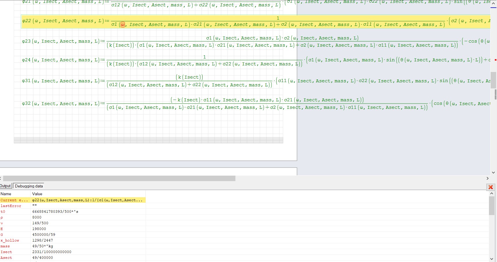

For KENNY: I'm trying just now your suggestion: a first result is that, in fact, DetZ() is passed away in 50' ...could you be so kind to give me a short hint on how the modification act ? Please,
keep in mind I'm nor a informatic expert nor a mathematicians but only an aeronautical/mechanical engineer with some basis of numerical calculation...
For JEAN, thanks again for all your efforts...about what you call "Clean roots", please take into consideration that complex results (with small
imaginary part, let's say < 5% of real part) are acceptable: it probably means that the vibration has components on both normal axis...
More, these methods are used mainly in preliminary dynamic&vibration verification (hence 5% error is more than good). By the way in one of the
original version of the my SMath file (ThreeHollowBeams_SteppedBeam) the calculation ended after 1h & 50' on solve (......) with the error message:
"No real roots"...I do not think it's matter of units (it worked in previous SMath files...). But on the other side, I do not know how could I ask to have even
complex roots...
Plus, do not consider negative axis and max the first 5 roots (lowest frequencies are always the most 'tedious' and a modal basis made by first 5 modes/frequencies
is more than adequate if we should want to consider an "answer" of the structure): this should limit the values (even if, to be honest with you, when I studied the same
cases in MathCAD, values of 10e18 were not uncommon).
Keep in touch
