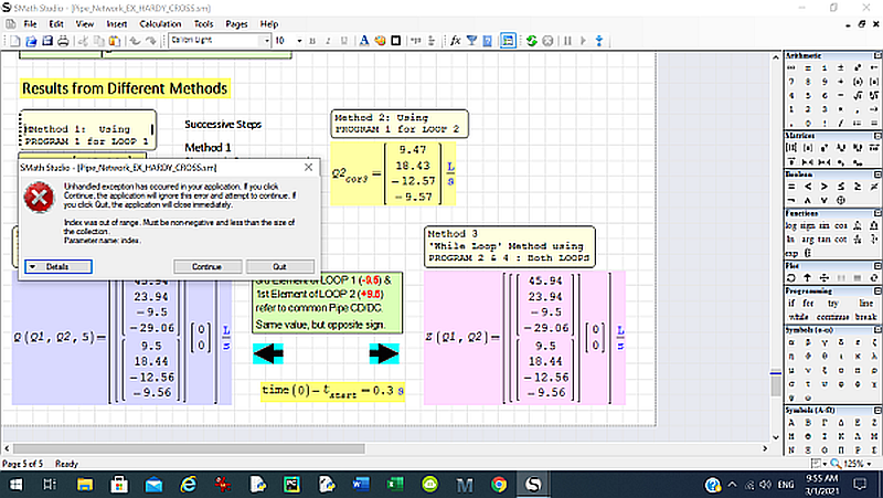

Whenever I try to edit contents of some description boxes the unhandled exception error message props up. For information of Developers please.
#8 Posted: 2021/3/1 07:41:53
1,435 likes in 2,913 posts.
Please attache the content of the "Details" window.
Details Window.txt (30.14 KiB) downloaded 589 time(s).
Pipe_Network_EX_HARDY_CROSS.sm (299.12 KiB) downloaded 806 time(s).
#10 Posted: 2021/3/4 08:53:47
2,315 likes in 3,949 posts.
Both issues fixed. Thank you!
