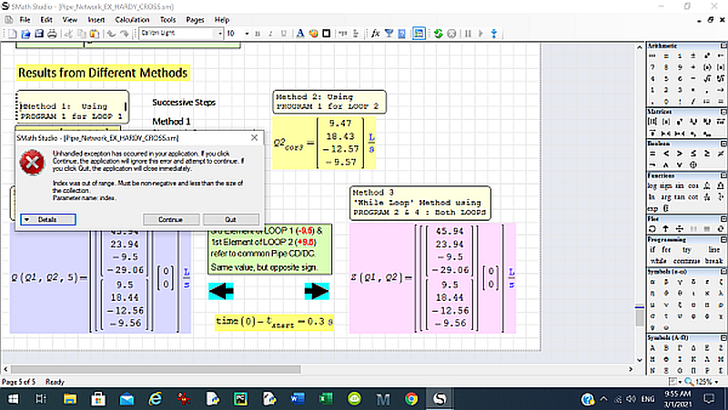

WroteWhenever I try to edit contents of some description boxes the unhandled exception error message props up. For information of Developers please.
Please attache the content of the "Details" window.
Details Window.txt (30,14 КиБ) скачан 1242 раз(а).
Pipe_Network_EX_HARDY_CROSS.sm (299,12 КиБ) скачан 1540 раз(а).
