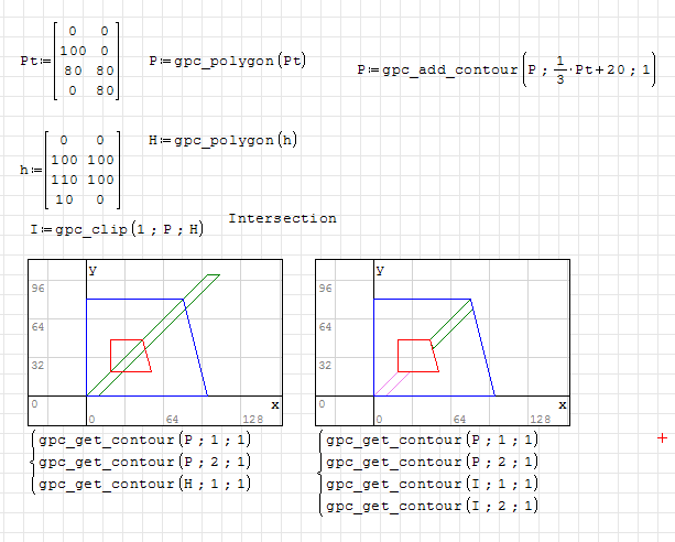

In regards to hatch and fill - do we have a Smath code that can hatch a closed polygon?
Try the gpc wrapper plugin by davide
GPC.sm (6.8 KiB) downloaded 1689 time(s).
